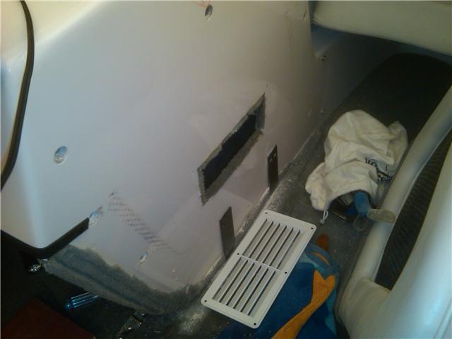

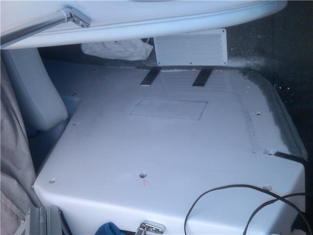

I used to use a rolled up towel or life jacket to prop up my seat alittle too, but it makes it awkward for someone to sit there and it puts alittle stress on the hinge if someone does sit there.. You'll want it up higher than an inch also.. I put one vent in the walkway and another down by the passengers feet.

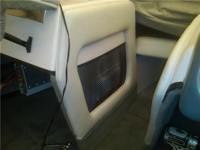

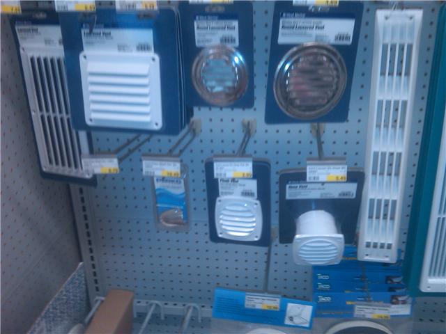

I bought the white vents from WestMarine.com.. I didn't want to use fabric incase I put something in the net pocket in the walkway that would tear it and with all the air the sub pushes, I thought it would get dusty and dirty pretty fast. But Seth's install looks great tho!
http://www.westmarine.com/webapp/wcs...classNum=12408
