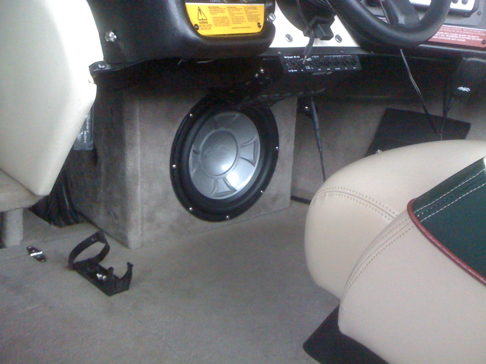

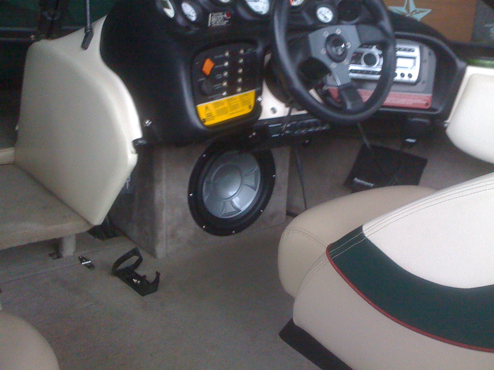

            I have mine below the helm. It hits so hard that a pair of pliers will vibrate across the floor with the XXX. I am not quite finished with the install. I have a carpeted trim piece to add on each side to hide the hoses. See below.
