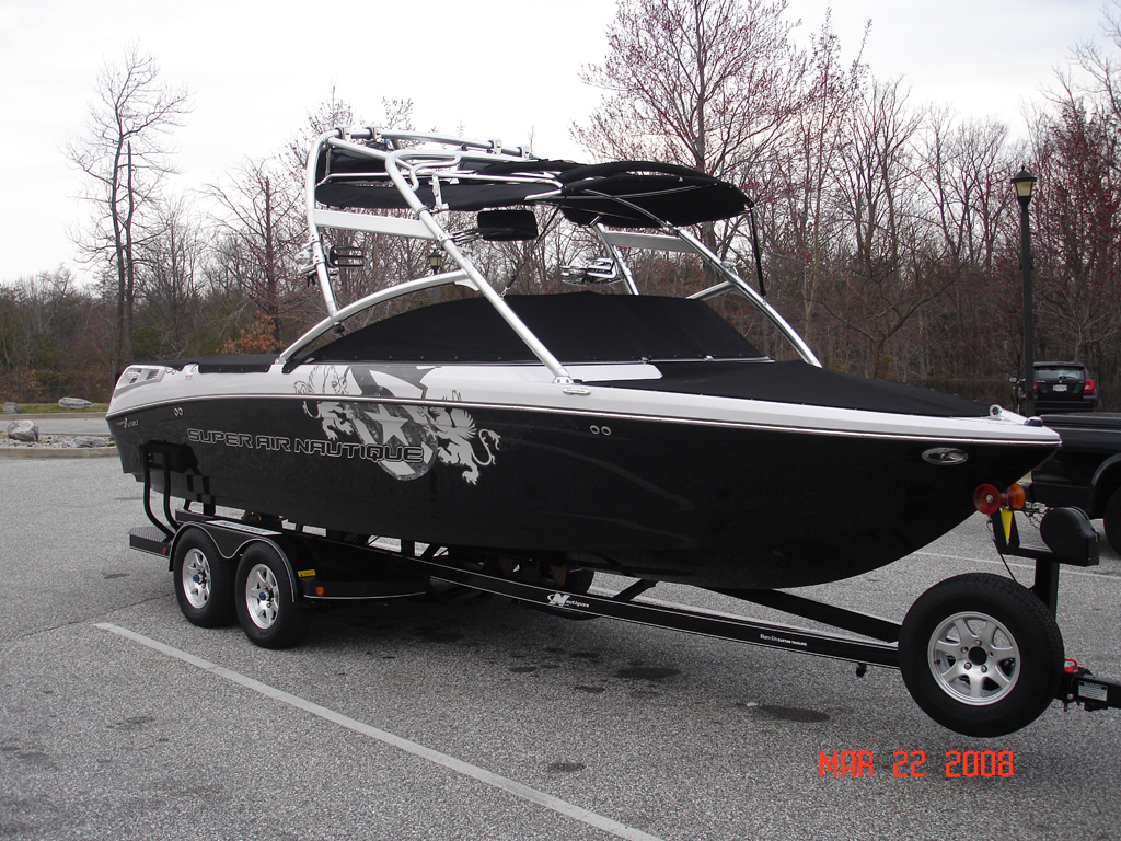

                            I had the 485's and a Z5 on my 230, and I carried boards up there all the time. They do not hit the speakers. See how far forward the boards would sit?

                              With the new FCT3 tower? They barely fit up there with the stock speakers and looking at Chattwake's setup, there seems like there is no way as the ends of the boards would hit.
