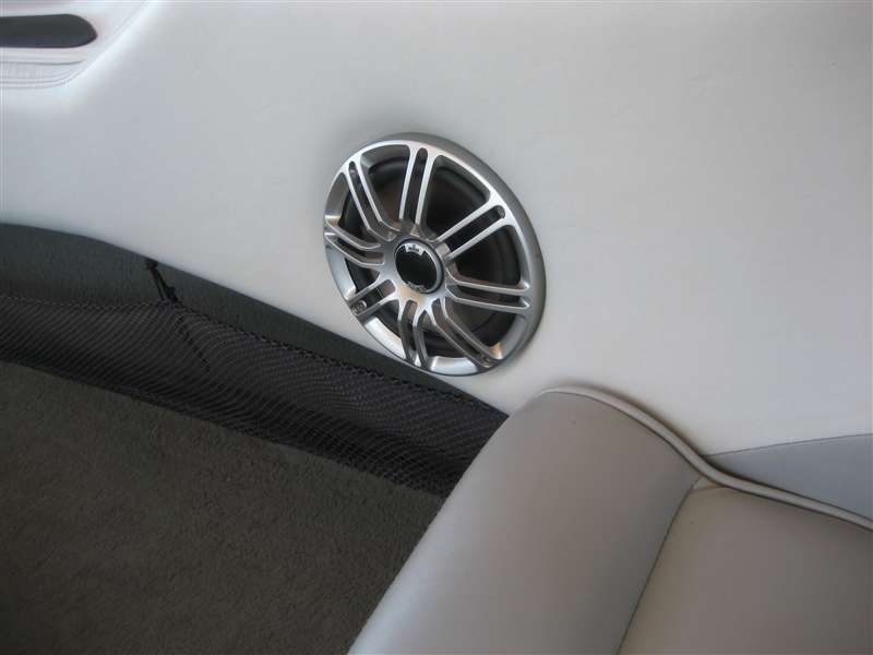

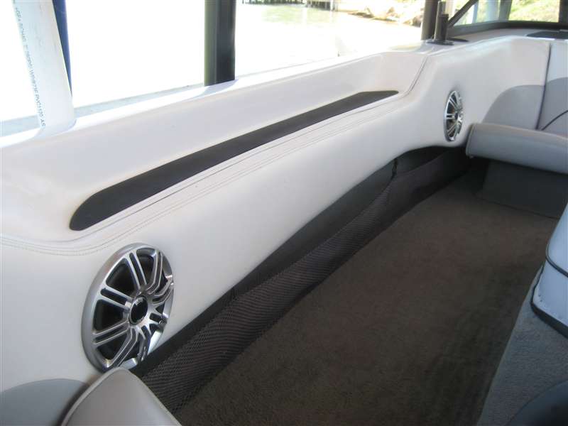

          I did this a short time ago. I have a post on here somewhere about how I did it. Here is a pic of where I added the 4th speaker to right behind the driver's seat. I had to cut a new hole in the starboard and the hull to do it, but I had no room on the driver's kick panel since I have 2x12" subs there. Sounds great to me.

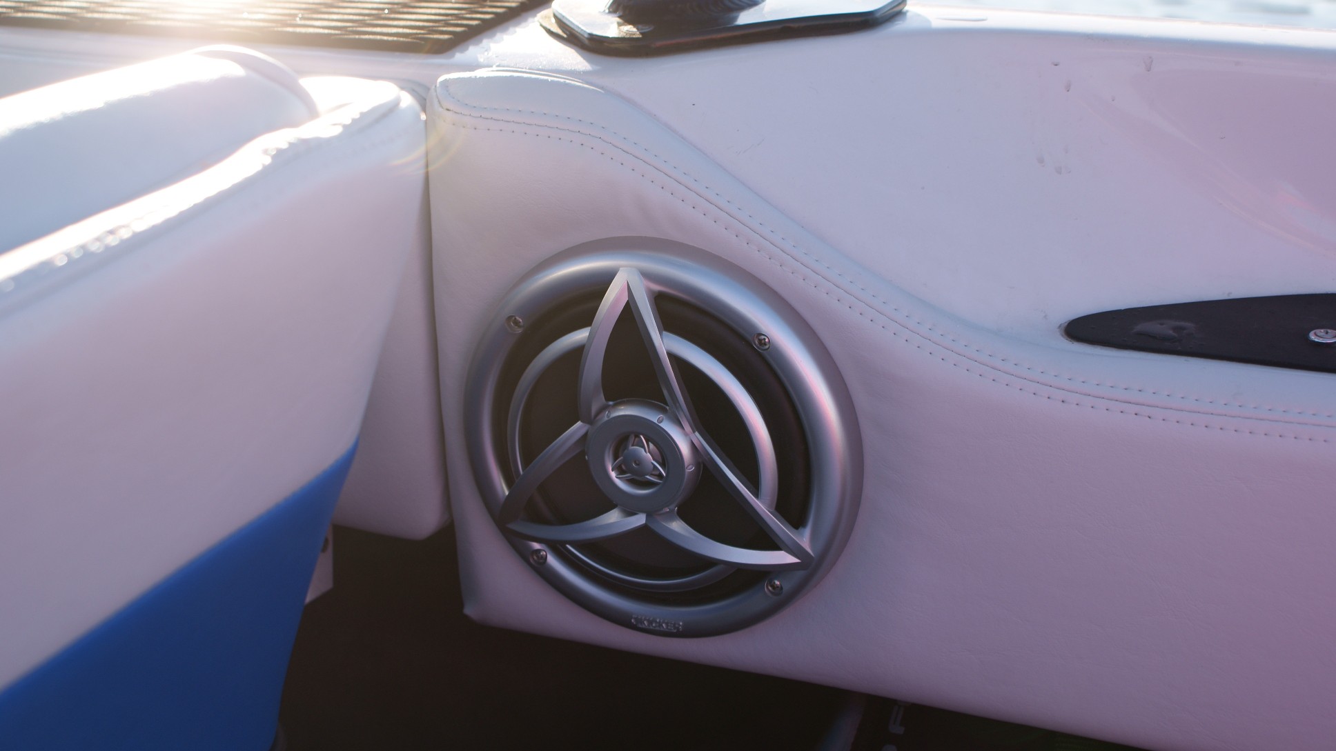

            Here are my replacement 6.5 top mounted

              Something to consider for those who have coaxial speakers mounted towards the edge of an open coaming bolster:
              In many of these applications, you can reach behind the open bolster from underneath and touch the speaker without obstruction. When the speaker is mounted just inches from the open perimeter, the speaker is undamped. This means the simultaneous compression on one side meets the vacuum from the opposite side and cancel out any radiation below a certain frequency or wavelength. This cancellation effect also serves to eliminate any air resistance that would damp the cone and restrict uncontrolled excursions. The net result is diminished midbass contributon and a serious reduction in power handling.
              The solution is to encapsulate the backside of the speaker with an injection molded isolation chamber. The small cup will raise the speaker/chamber collective resonance so you won't gain much of the lost midbass. However, you'll see an increase in overall output and a dramatic improvement in power handling.
              I recommend this whether your coaxials are running fullrange or highpass (used with a sub).
              In advance,
              If your mounting already provides sufficient front to rear isolation then this chamber serves no purpose. All inboat or automotive coaxials are ininite baffle so a large volume of air behind the speaker is preferred... As long as you have isolation.
