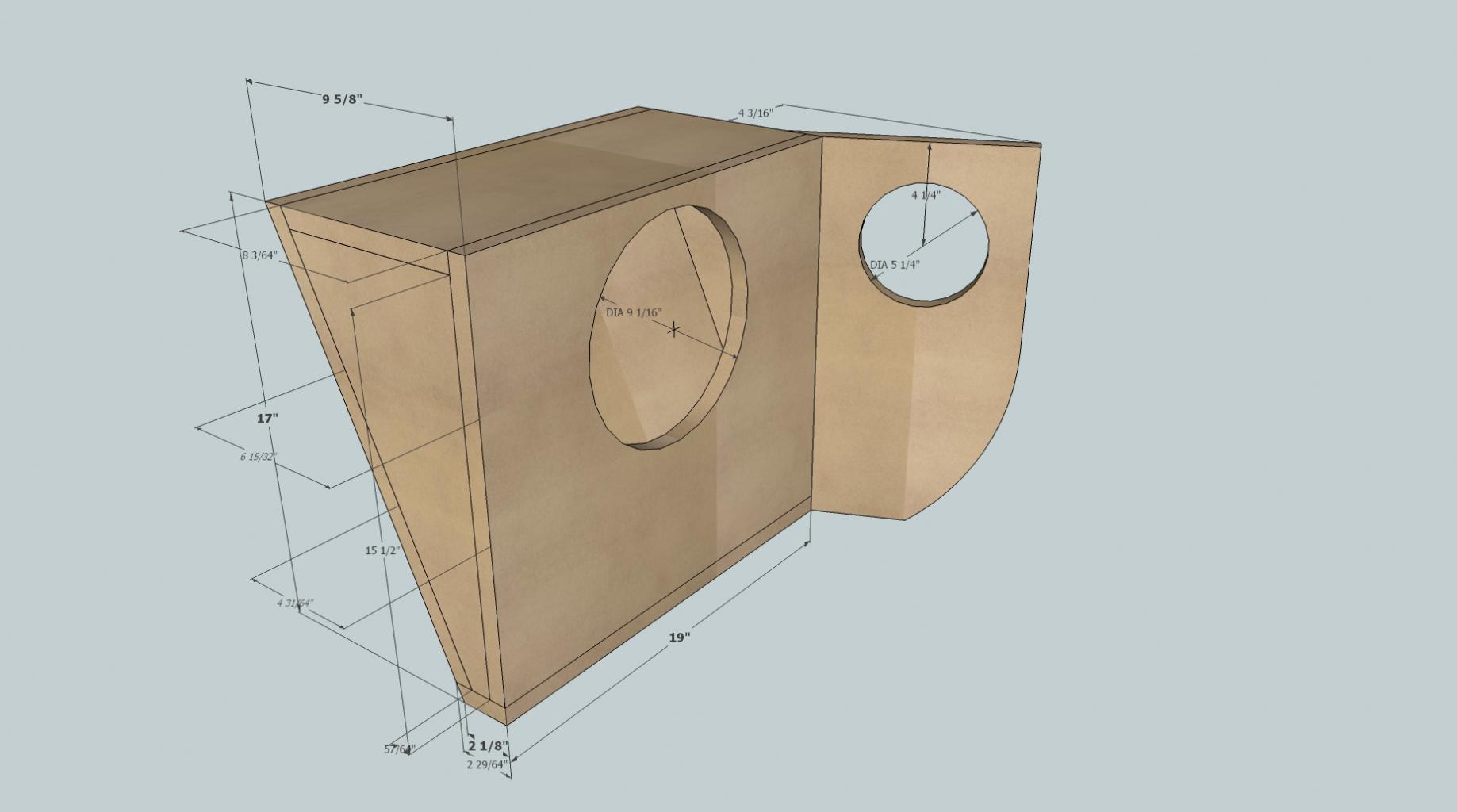

                    #24
                    This is what I am thinking of. It figures out to be .68676 ci without the sub, with the JL Audio 10W0 .65276 ci, just about what they recommend.
                    thoughts, comments? The 4 31/64" at the bottem of the hole to the back of the box is a little tight, the total depth of the sub is 4.9, but with the "slope" of the sub I should be fine...we'll find out.
                    Google sketchup is AWASOME!!
                    Oh yea, SN 176

                      #25
                      well back to the "drawing board" 17" is too tall. It hits the horn enclosure. Good thing I mocked it up in cardboard.
