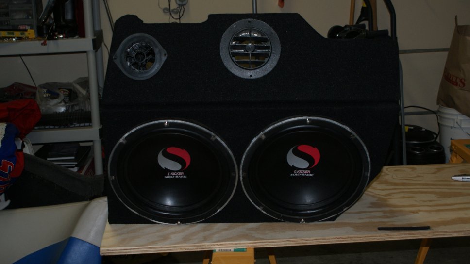

        Here is my sub box out of the boat
        Here is my sub box out of the boat. I will take some pics this weekend of the space behind the sub and the subs put back in place.
        If you do not have a sub already, consider the Kicker marine 10". It's very shallow and could mount pretty easily down there I think.

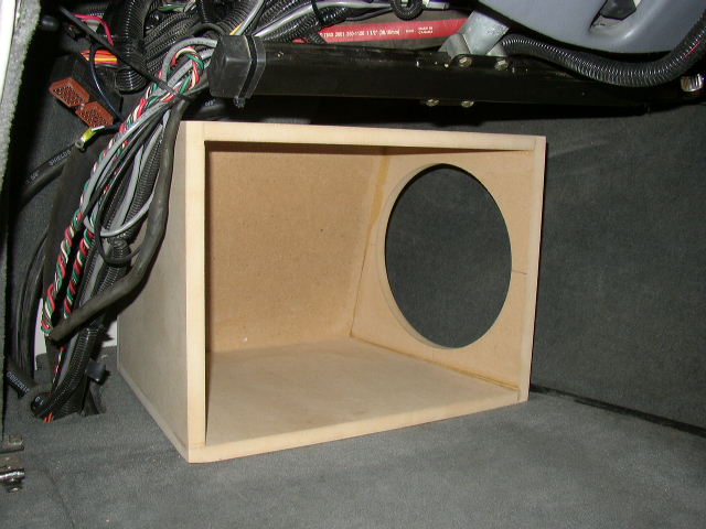

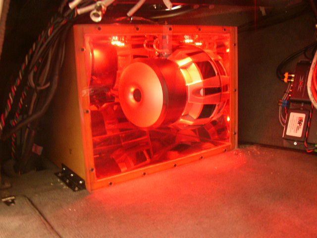

                    i have a 2001 air and am also in the process of building a sub box. one thing to remember is that the 1999 air's did not have a computer box.
                    anyways, have you taken a look behind the panel yet? it is a mess, especially with a heater in there. we didn't feel like making a whole new panel for everything so we just made a sealed, down-firing box that will fit behind the left side of the panel. it is an extremely tight fit and the specs are not quite right but it should add some thump.
                    i will try and find some pictures.

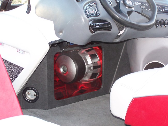

                              here are a few pics with the wiring all relocated on my 2001 SAN , the gas filler hose had to be lengthened as well to accomodate the size of the box.
