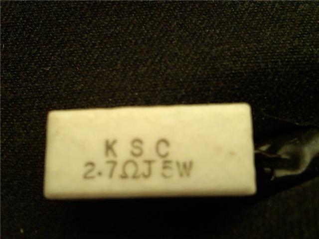

              David, that is exactly how everything is set up (two pair of cockpit coaxials run off two amplifier channels and the bow coaxials run off the source unit front channels) except that 3 inches off the amp the two cockpit coaxials have resistors. Took a picture of one of them (the non-burned one) to give everyone a look at what it was running. So now the system is running the way I'd have designed it originally- without any resistors... unless someone here thinks that is a big "no-no"
              Thanks to all for the help and insight.
              (sorry for the bluriness- camera phone)

                as long as your amp is stable with the current setup, then i wouldn't give it a second thought! i would highly recommend checking the resistance though!

                  I would highly recommend pulling the resistors out and if I were a betting man (which I am) I would say someone thought that was a great idea to run all six speakers off of one amp. (it doesn't work, you're only increasing the OHM's for certain frequency ranges) which is why people put mini caps and resistors inline to cut bass frequency. I wouldn't leave those in there for fear of damage to an amp.
