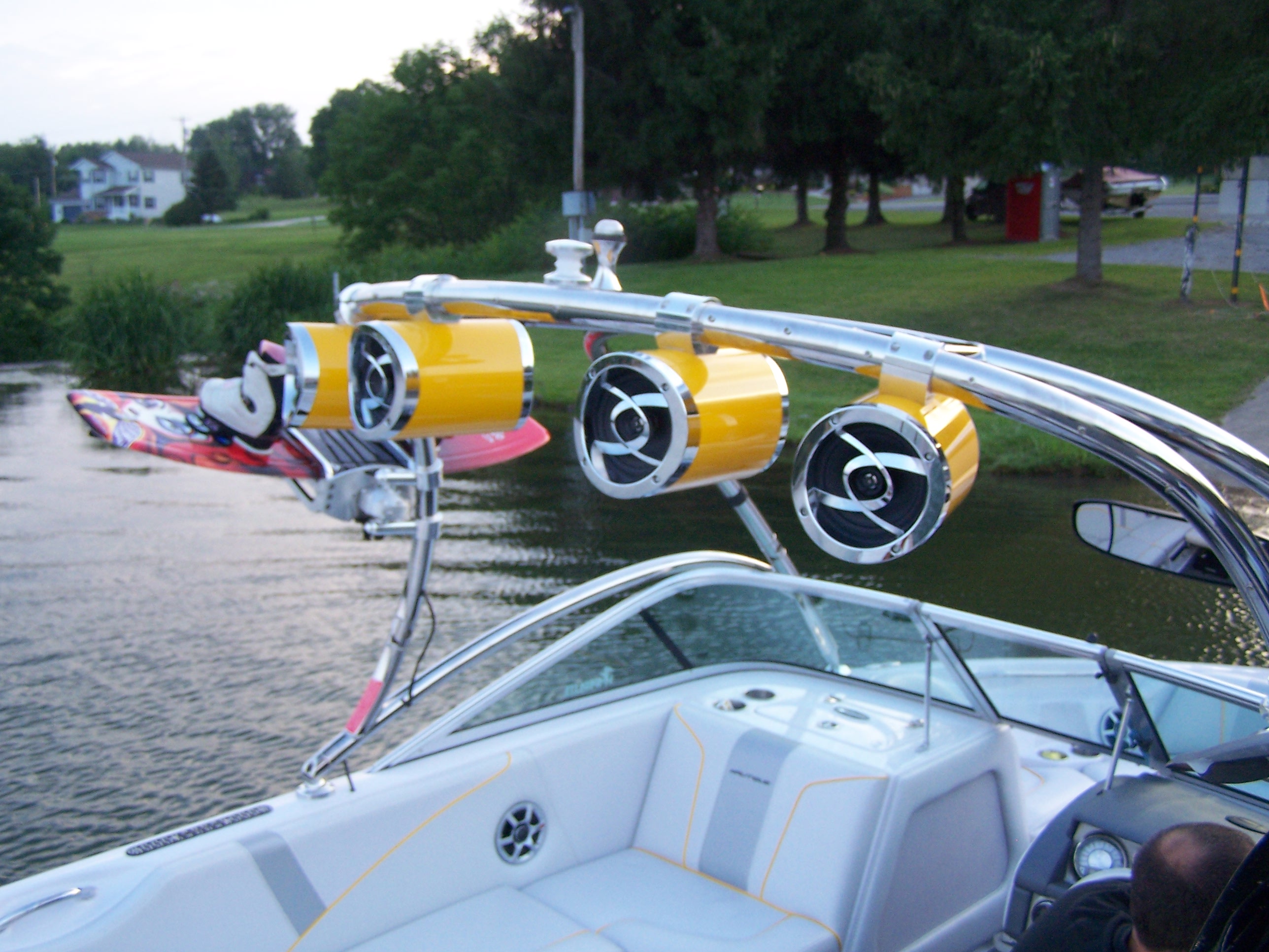

    I am wanting to rewire my tower speakers but am not sure what guage wire to use. I want to run four wires up the tower since I have a four channel amp (JL 300/4). Also will I run into any problems fitting the wire through the existing holes on the tower? The factory only ran two cheap wires and split off of them for the four tower cans. How much wire do you guys think I will need and what brands of wire do you all recommend? Will this be as easy as hooking up to the existing wire and pulling the new wires through? This is on an 08 210 with titan tower. Thanks for the help.

    Definitely run 2 sets down through the tower. Unhook the factory wires, tape 2 sets of speaker wire (no smaller than 16 gauge) at different points and pull them down and through the holes to the amp. The factory wire isn't bad or too small, but its super stiff.

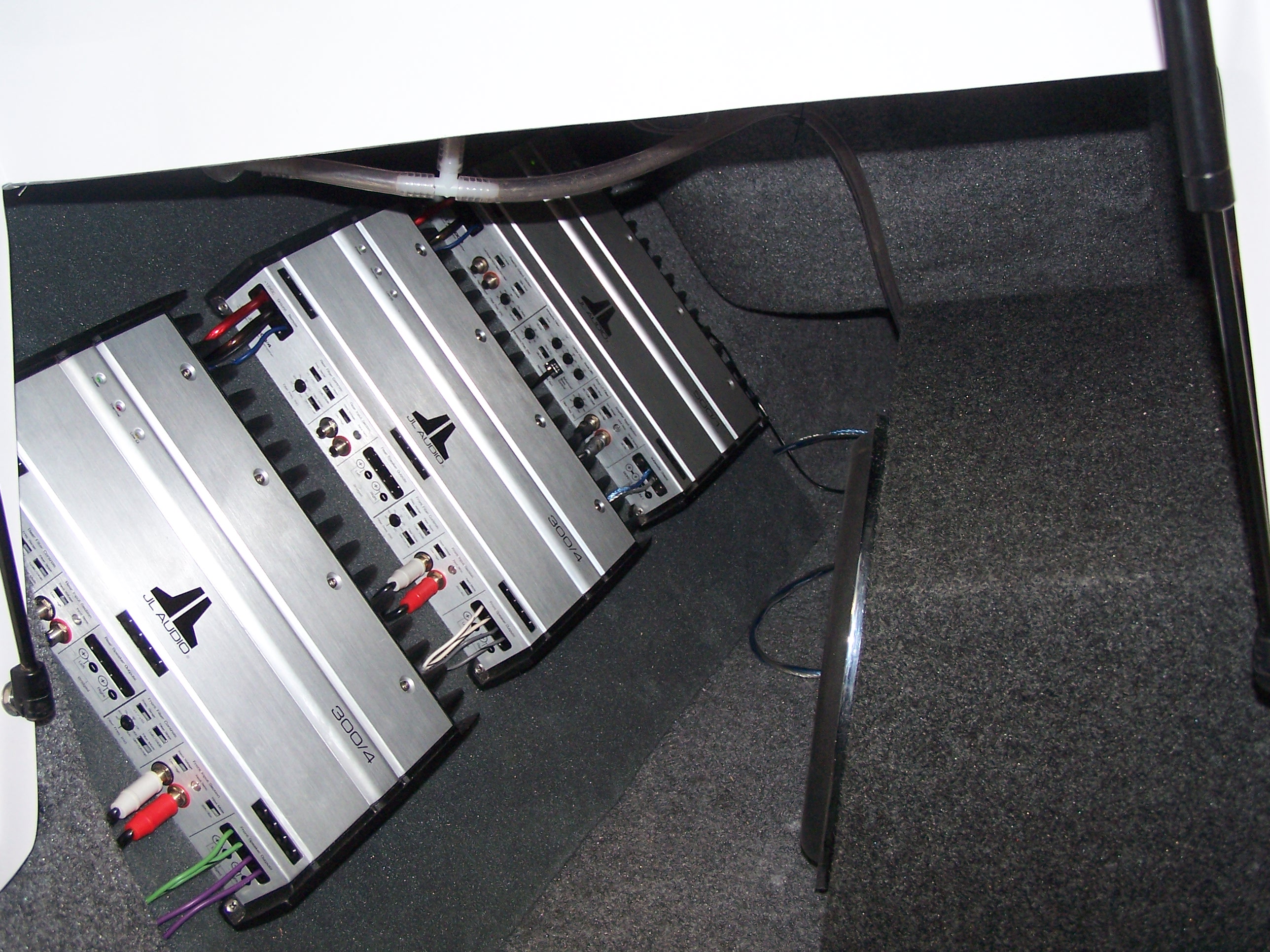

          Either way, that's a "clean" installation of the amps.

            SuperSquirt, the sub is an Audio Bahn. It is one of the older ones when Audio Bahn made good equip. I have messed around with moving the box in various firing positions and that seamed to work best. The sub is actually in a ported box now and has a lot more vibration, but doesn't have that tight snap of a sealed enclosure.
