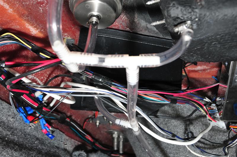

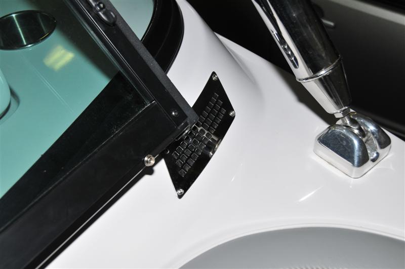

    My first question: There is a vent in front of the windshield. Under that vent (inside the passenger console area) is a black plastic box that is open on the front and close (but unsealed) on three sides. A drain fitting is attached to this box, but it looks clear that water coming in through the vent could easily splash/run out of the box without going down the drain tube. Of course, if this happens, any amps or electronics I have mounted under the console might get wet.
    Does anyone have a solution for this issue? It looks like I can seal the back and sides of the vent box with caulk, but the front is still open with no baffle to prevent water from flowing out the front and into the console area. It could be this isn't an issue and water doesn't spill out of this box....(?)

        I can tell by looking at it: if I pour a glass of water through the vent, it will collect in the black box shown in the photo and then run down the clear plastic drain tubes (shown in the photo) and dumped into the bow locker. The vast majority of the time, this is what will happen to any water coming through the vent.
        The problem would be if a lot of water came into the vent at once or if the boat bounced around such that any water collected in the black box spilled out over the front edge of the box (the front edge is not visible in the photo) or around the top of the box where it meets the fiberglass of the deck above it.

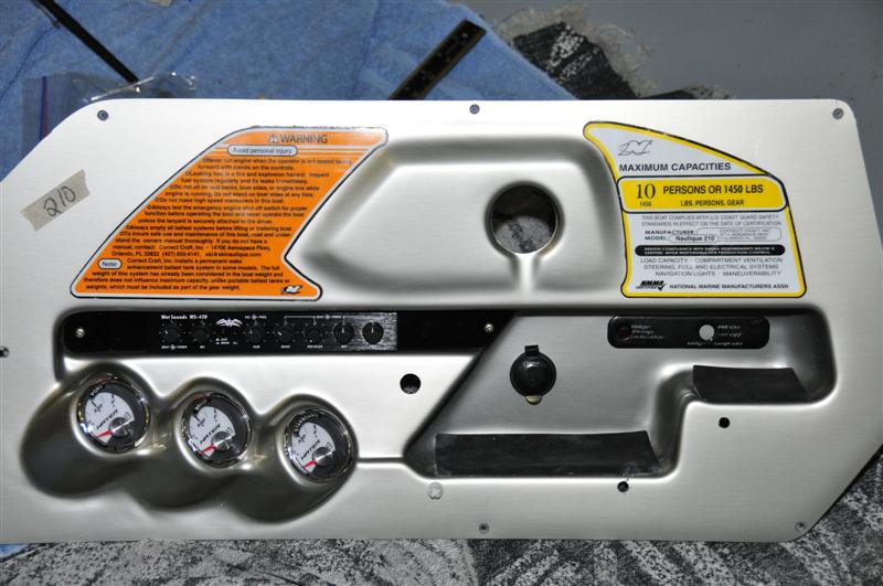

                    I spent quite a bit of time today on the WS420. As with everything, it takes me twice as long as I think it will. I still have to finish making a bracket behind the panel to hold the WS420 securely, but this is how it looks. I moved the primary power switch and the bilge indicator light and then did some cutting to install the WS420. It doesn't show as well as I'd like because I mounted it against the existing black insert...but you get the idea.

                      I took a closer look at the vent / horn on the passenger side. As it turns out, the horns reside in the black box (I posted a photo previously).
                      Just to be safe about keeping water off my amps, I figured I'd sacrifice an old Gore-tex windbreaker and glue a piece of Gore-tex to the underside of the chrome vent mounted on the deck. When I pulled off the vent cover, I found black fabric attached to the underside via caulk or glue around the perimeter. I ran water on it and nothing came through the vent...obviously, low pressure as I just held it under the faucet, but it's definitely water-resistant at the very least.
                      Does anyone know what this fabric is? (e.g. is it waterproof like Goretex or is it just tightly woven and it just happens that water doesn't drip through it when I hold it under the faucet?) There is a drain hose hooked up to the box attached under the vent, so it looks like the thought is that water will get past then vent.

                          I think the primary purpose of the fabric is to keep water from splashing in there, but allow it to air out. I don't think it's water proof, but more of a barrier against direct splashes and dunks.
