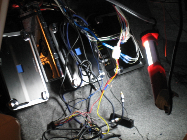

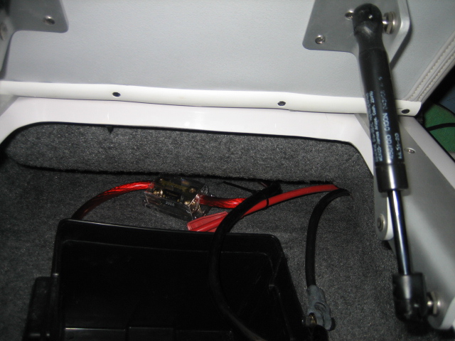

You probably can't tell in my pic, but I used 0 gauge wire off pos. and neg on the battery (with a huge 200amp fuse) to the capacitor. Then used 4 gauge into two distribution blocks tucked above the amps. I know it never hurts to have extra wire, but having a few extra feet of 0 gauge can definitely get in the way.
