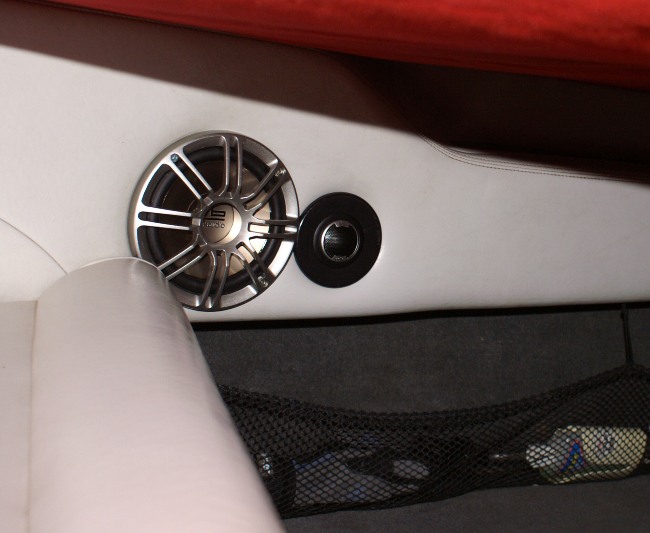

        I did it last year and it's holding up fine and looks great. I left the PVC ring intact and cut a criss-cross patter in the grill cloth. I set the speaker in the recess and once I was sure it was in straight, I carefully screwed it in with a screwdriver. The vinyl is pulled in and there is vinyl piping around the speaker cutout. So I wasn't worried about the vinyl pulling at the screw holes. The screws are pulling on the backboard and the vinyl doesn't seem to be pulling at all. No problems at all with it since installation.
        Here's a quick shot of it under the cover. This is the component in the rear (previous owner had installed component speakers, which were also replaced). Coaxials up front.
