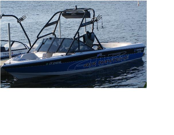

                      Yes, mine is the Blue/Black one. I absolutely love the color scheme. I also much prefer these graphics to the smaller "AIR" symbol that followed it in later years. It contains the perfect mix of understatment and flash. Even with the interior vinyl in really bad shape, I get a ton of complements on the look of my boat. Last season I had a guy with a new MC X1 (the old X-star hull) gush over my boat. It was great having someone with a brand new very nice boat keep staring at my boat and finally come over and ask me about it. It didn't have the heart to tell him that I paid only $14k for it.
                      Here is a pic. It's the best I can do at the moment. I have replaced that rack with 2 sets of flight clips. I have also added a 3rd traditional rack from bulletlines on the round cross bar below, so I can hold up to 6 wakeboard/skates now. I might add a 4th rack for a wakesurfer as well.
