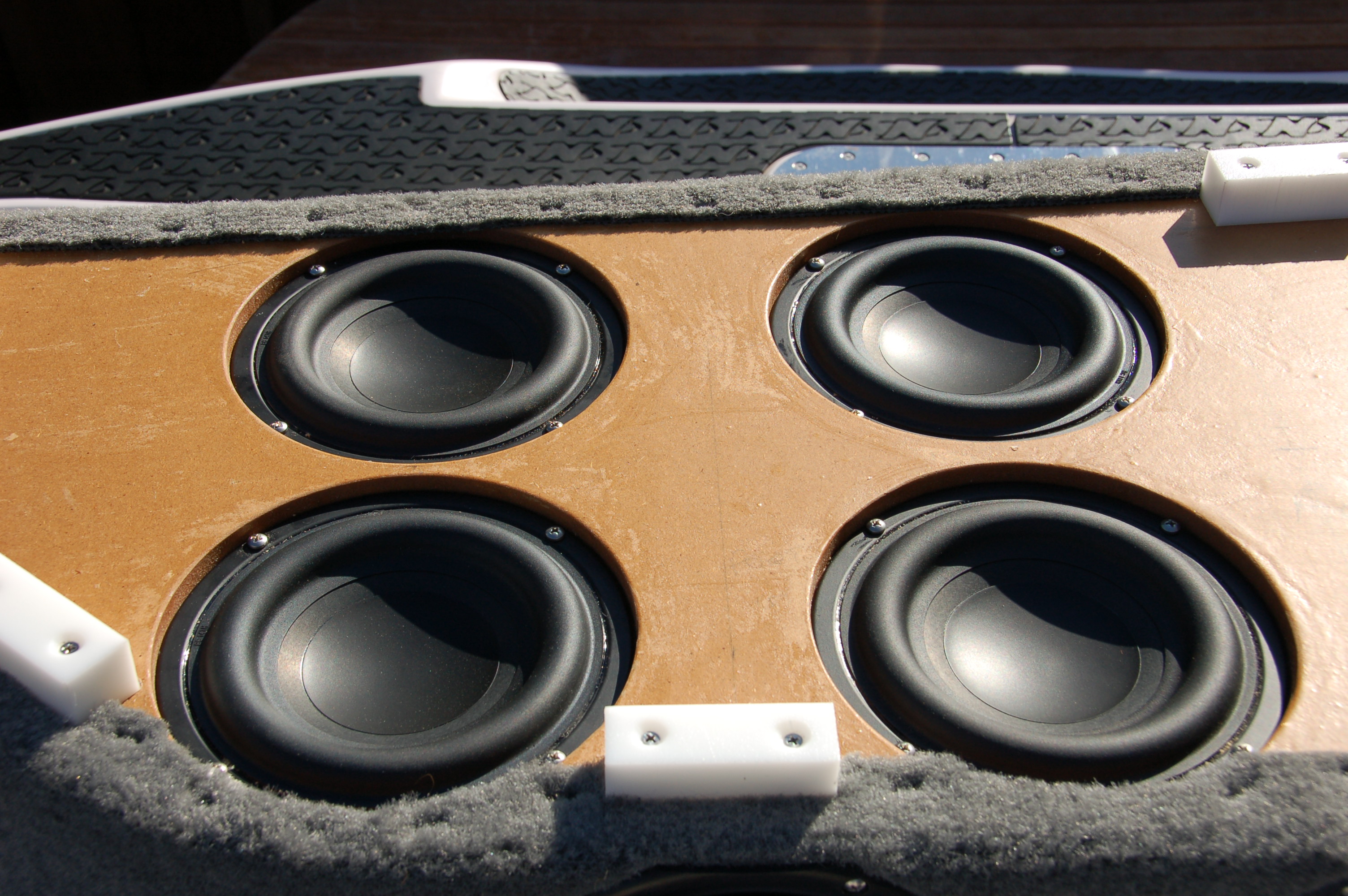

        I made feet for my seat sub from 1" cutting board material from Tap Plastics.

          That looks pretty clean. See if I can find some of that stuff. Thanks for the help and nice looking bass package.
