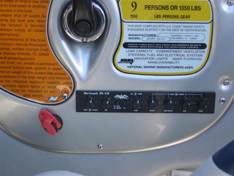

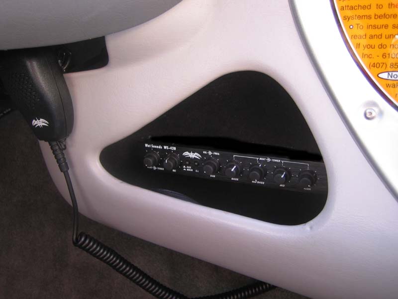

Mine came with two small angle brackets, I did not use them. I bent up some aluminum flat plate to make a backup bracket for mine. I would suggest you bend up a U support, use stainless hose clamps to attach it to the steering rack. You might need to add some rubber hose between the clamp and the rack. Velcro will not work, tie wraps will hold for a while. Boats take a beating, it needs a strong mount.
Wow! Yours looks really clean. I imagine you did some dremeling and cutting to get it to sit flush in that area? I'm trying to stay away from excessive cutting.
Agreed. That looks great there.

I just checked the placement of where Mikeski put his WS-420 and it must work perfectly for the 210. It doesn't however work so well for the 220. It seems theres a great deal of space for that console to accomodate the 7 inch width of the unit. Mine however only allows about 6. So no dice. I wish it would work though, because theres a good foot of working space behind that console.
Also Mike, where you did you pull the wiring for the PA system? I imagine you used an extension and ran the wire out from under that console area?Originally posted by MikeskiMine came with two small angle brackets, I did not use them. I bent up some aluminum flat plate to make a backup bracket for mine. I would suggest you bend up a U support, use stainless hose clamps to attach it to the steering rack. You might need to add some rubber hose between the clamp and the rack. Velcro will not work, tie wraps will hold for a while. Boats take a beating, it needs a strong mount.
I have a 211, there is plenty of depth, maybe 12" behind that plate.
The PA mic is plugged straight in and the mic just drops in the storage pocket below the ballast gauges.
I used a dremel, file, and sandpaper to cut it the plate to fit the EQ, it's not that hard just take your time. The faceplate of the 420 is a bit bigger than the body so it covers any minor error. My previous soundstream EQ was flush, the hole had to be perfect for it. One trick is to use black electrical tape to tape around the backside to keep light from coming in if there is any gap.
