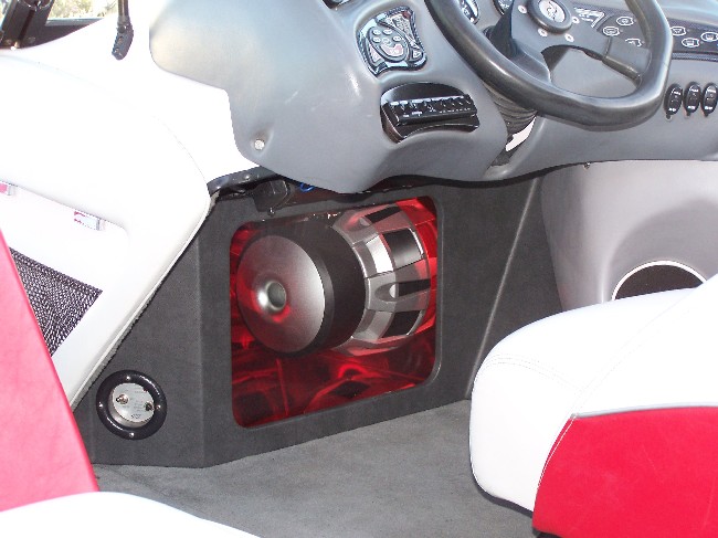

I'm definitely excited about the sub. I think I'm going to have a ported enclosure made. Probably won't be made to spec since it is requiring about 22.5 x 15.5 and I think thats definitely a little bigger than I have to spare. My system should be almost identical to the link I posted of that 220. I actually spoke to Robert the owner of that boat and he loves it. The only difference between mine should be the tower speakers (I'm using NVS) and the amplifiers (I'm going with Kicker). I also won't be running any different batteries at this time. With only 2,000 watts to two batteries, I think I should be good until at least next season -- at that time, I may decide to upgrade to blue top optimas.

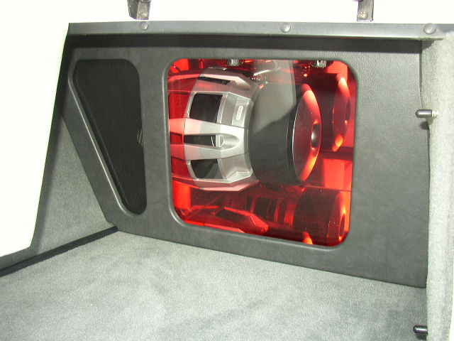

You say sealed...however you have 3 of them. I'm sure you have plenty of boom. I'm also certain had you gone ported you probably wouldn't have had enough room, and secondly it would've been ungodly loud. I am however only running 1 12W7 with a 750 watts to it. I talked to JL and a few other individuals, both installers professional and amateur and they've stated to go ported specifically since it is a boat and due to the open air environment it is justified. Thoughts?
It has been my experience with the w-7s you are going to get louder bass with the sealed box, again just my thoughts. If you ask me a car audio shop doesn't know jack about how something is going to sound in a boat unless they do a lot of these big systems in boats. It all depends on what you are looking for out of your system what sounds good in a car isn't going to be the same in a boat. I am just giving you what works for me and my w-7s.
It does not matter if the sub came from JL Audio or Radio Shack, a ported enclosure ALWAYS produces more volume. Simple physics; a sealed enclosure only uses the soundwaves coming from the front of the cone, a ported box uses the front and rear soundwave. However, I am sure 3 sealed w7's in a 210 hammers. What size are they and what amps are you running? Did you have to upgrade the alternator?
OHL, i'm giving you 5 seconds to take back that comment using JL Audio and Radio Shack in the same sentence. Have you lost your mind? Statistics and physics don't mean diddly squat to your ears homeboy, only your eyes. JL Audio's W series subs are so precise and sound better than any sub that I have ever heard, even in a small sealed box!
They are the 12 w7s and I am running Orion XTR pro 2400's, 1 amp to each sub at 1600 watts each, Balmar 210 amp alternator with 8 blue top Optimas.
