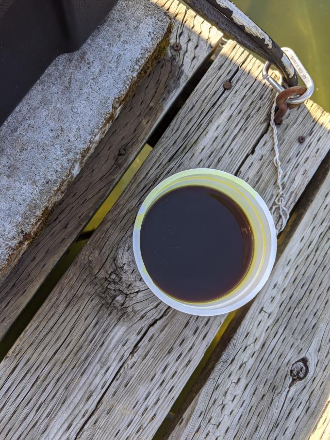

    Replaced the hydraulic fluid in the lift today.
    Here's what came out. At least 6 years old...maybe more..dunno.

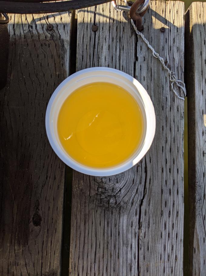

    Here's what new fluid looks like. (Mobil 102570)
