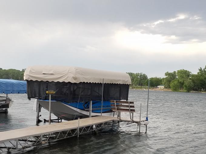

                    I am late to this one...But I gotta put a plug in for the Shoremaster 50120. Cantilever, with non-stock winch.
                    If I was to get something else it would be hydraulic, probably cantilever.
