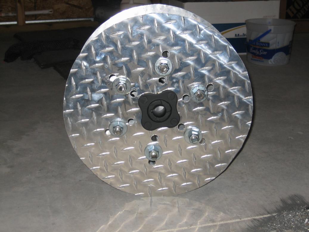

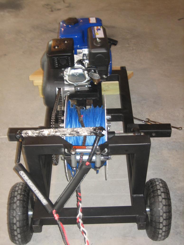

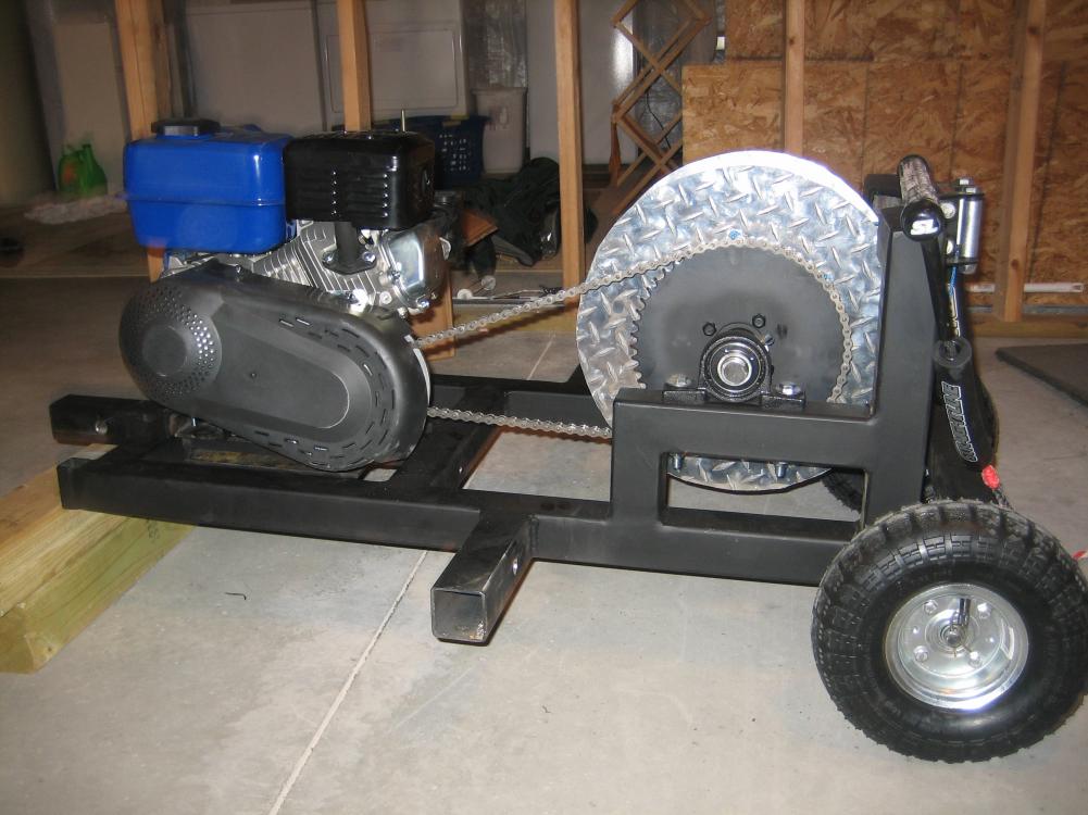

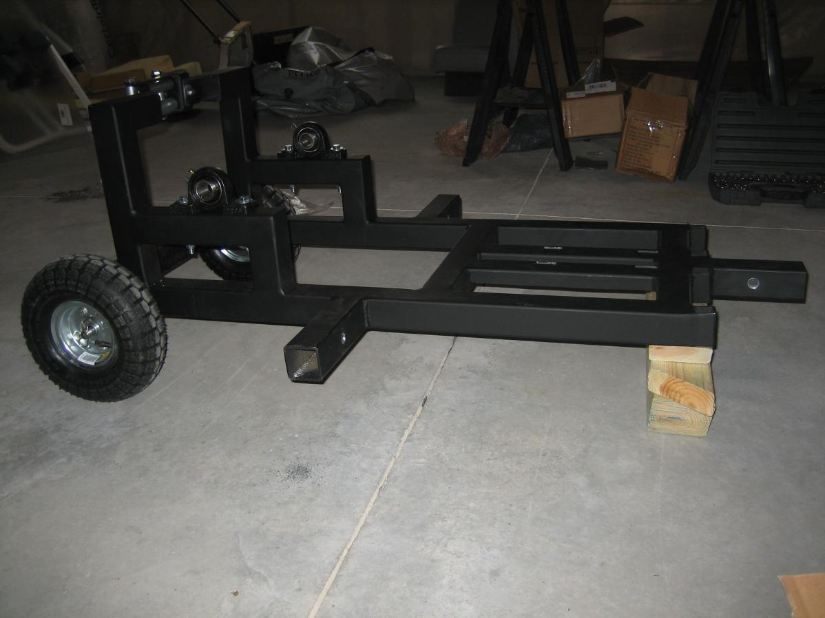

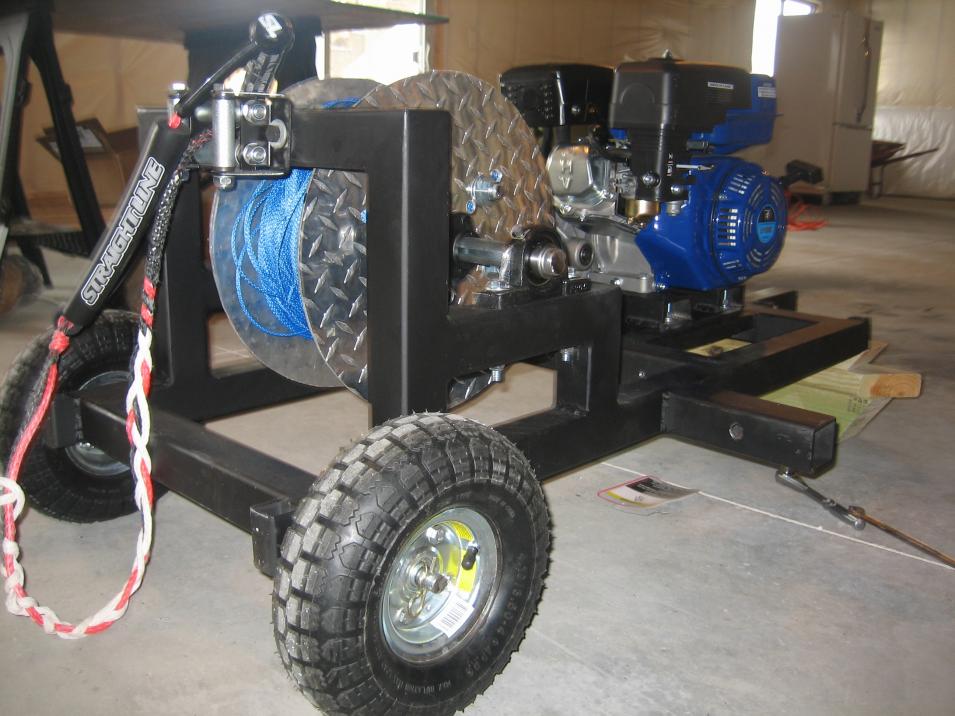

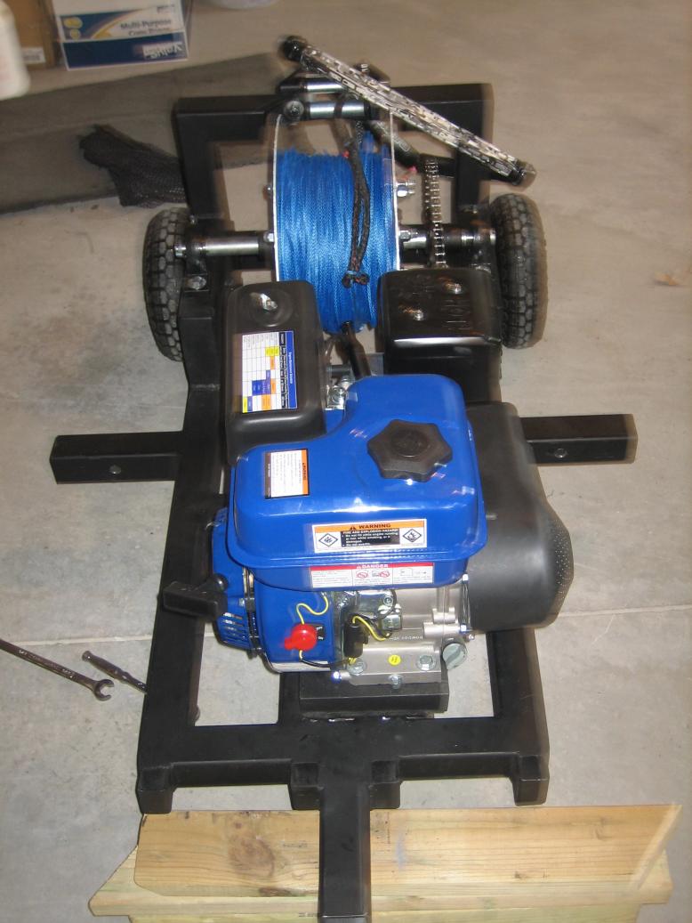

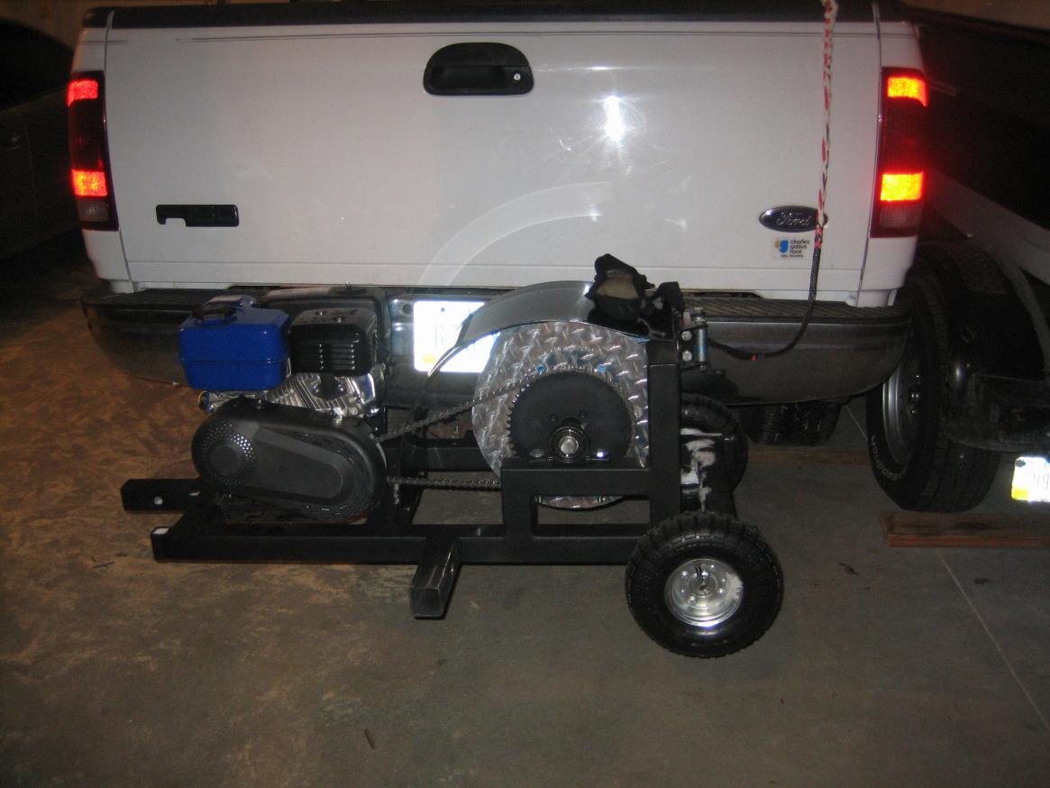

I had a blast doing it and now after building one i'm itching to build another to improve on the design!
Yes I have for only a few hours, we just got snow back this last week. I've been building a kicker the last few nights hoping to hit it this weekend!
here's a Youtube link of it in action.

Looks good. What's the HP of the motor?BKinSoCal - Brian

do you really think that 6.5 hp is enough for this work?
you should use a more powerful motor for this kind of work
A 6.5 with correct gears and spool inner diameter is plenty. I sold mine that had a stage 1 hop up kit, tav 2 and 58t sprocket and it deep water started up to approximately 210lbs And went about 23mph or fasterwith a 6" spool inner.
It ended up being around $825. Thats with the brake set up and thumb throttle I added after I posted this.1998 Correct Craft Air Nautique DD
