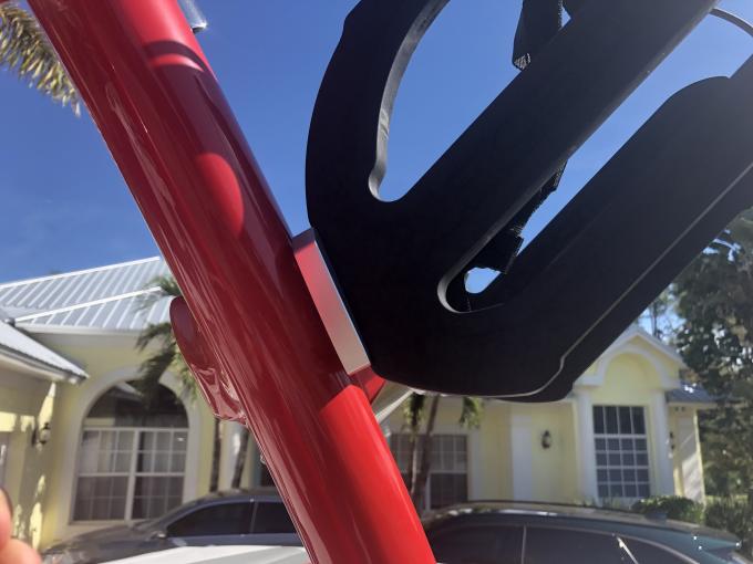

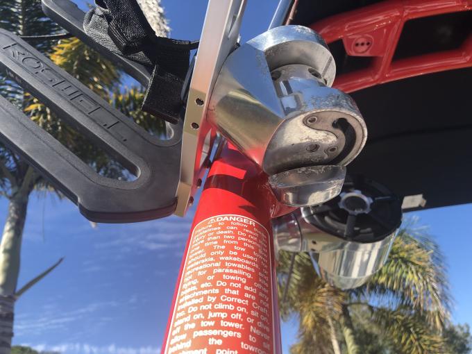

    i have a 2012 210 with a Roswell tower. Just bought a pair of Roswell racks that hold one surf and one wakeboard each.
    After installing on the nautique swivel mount, the rack now won’t fully open so that it locks into place when swiveled outside of the boat.
    Does anyone know of any after market extensions that resolve this issue?

    You need to call Roswell. They make a round extender piece which pushes the swivel out further so it can rotate around the tower bar allowing it to open to it's full outright position
