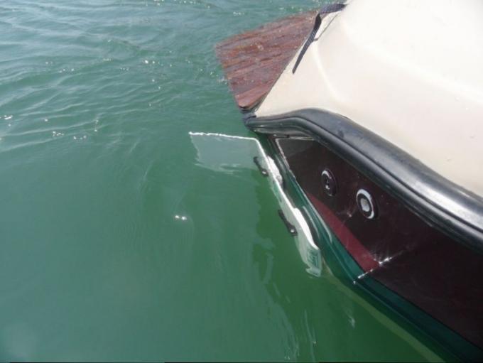

                              Finally got the Nauticurl wet.
                              I first attached it like this.
                              No ballast filled and I got a really nice clean wave that I could almost surf.
                              There was a big spray coming from the wake shaper though.
                              Then filled 2 540's in the rear. Didn't fill the front 'cause the bow bag is a royal pain in the arse to empty, and I was with wife and kids so didn't want them to wait even longer. Yes auto-ballast is going to be the first major upgrade...
                              This set up turned it into a huge white washy mess. Put wife and kids in bow, but that didn't change it.

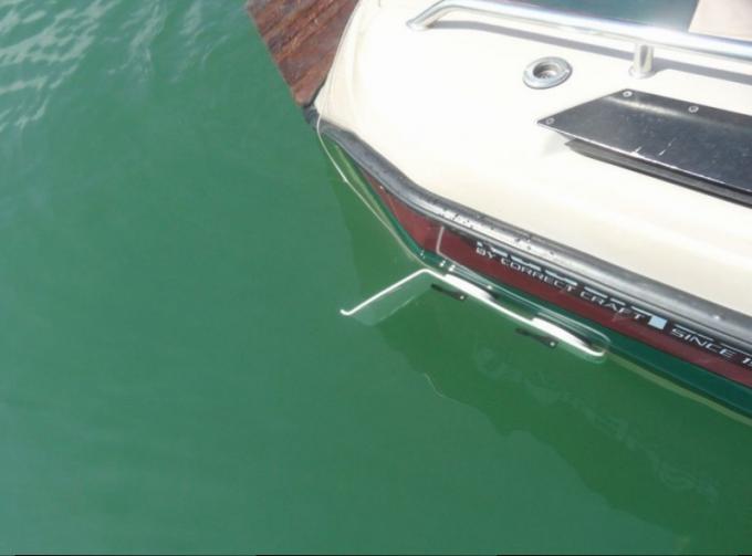

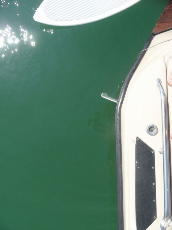

                              Moved the shaper forward a bit.
                              Got quite a bit better straight away. Still not great, really short and still washing out a bit, but I could surf that no problem, together with my daughter. The spray that came off the shaper earlier was also gone.
