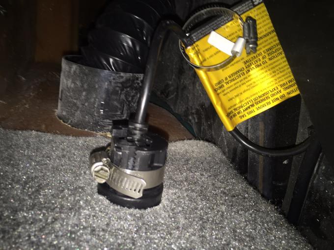

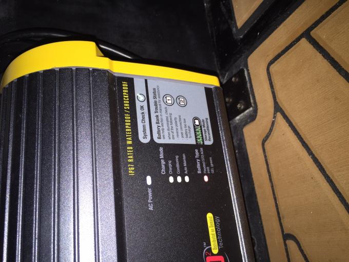

I have a ProSport charger on my Nautique G25. I installed a AC Plug Holder in the boat to assist me in making it a clean and simple way to charge the batteries. The issue I was running into was the plastic clamp on the back on the AC Plug Holder was always coming loose. The 2 super small screws did not have enough bite into the plastic to hold the AC plug in place.
So my simple and cheap solution was to go buy 2 2" hose clamps and clamp the AC Plug holder together in the spot it needed to stay in perminatly. In doing this I could really get a great grip on the AC Plug with this plastic holder now.
So when I plug in the female end of the plug on the Male end of the Charger it does not push back into the clamp and become useless.
Hopefully this will be helpful for anyone else have the same issue that I am or have had.
