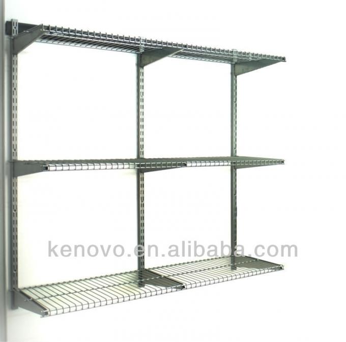

              Better to place the boards downwards so dry better and get no dust inside boots. This is similar to the one I use, but only two rails attached to wall and more removable triangles (no shelves) that I cover with foam/rubber to avoid scratches on the board.Click image for larger version

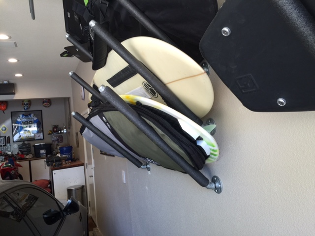

                    Made racks last weekend they are super strong as well since the floor mounts bolts directly into studs.
                    I bought everything at lowe's and it all out of 1/2 inch galvanized pipe.
                    1/2 Floor Flange
                    1/2 X 24 inches Galvanized pipe
                    1/2 X 45 degree elbow Galvanized
                    1/2 pipe cap
                    1/2 inch foam pipe insulation.
                    Even mounted my stand up Paddle Board off the ceiling with 1 1/4 Galvanized pipe as well..

                      Those look sharp Dave... Any chance you have a photo without the boards to see the base/mount?
