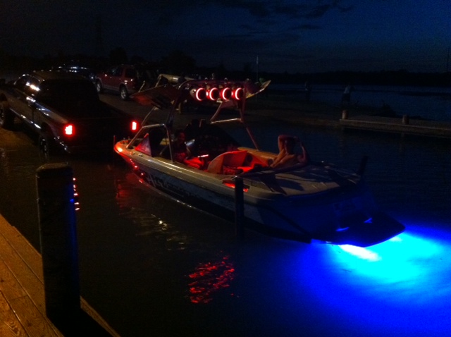

          This is a single 1200 lu puck LED on my Malibu:
          This is what 2 Hurley Puck LEDs looks like, this is 2400 lumen:
          And on my current G I just put in a pair of Lifeform 9s, 5274 lumen... I havent put it in the water yet, so we'll see how doubling the lumen really translates to brightness:

                I have ran 3 configurations:

                      Lumens is an unqualified spec within the underwater light business and very hard to compare from brand to brand.
                      Look at the amperage draw. The efficiency of underwater LED lights run fairly consistent. In my experience, the amperage draw and brightness ran parallel.
                      I have
                      (2) Lumitec Seablaze 3s in blue and they are amazing. Probably not quite as bright as the one listed due to slightly less amp draw, but are significantly cheaper than some other out there... see the link for the best price I've found
                      http://www.tacticalwholesalers.com/L...8_p_92725.html

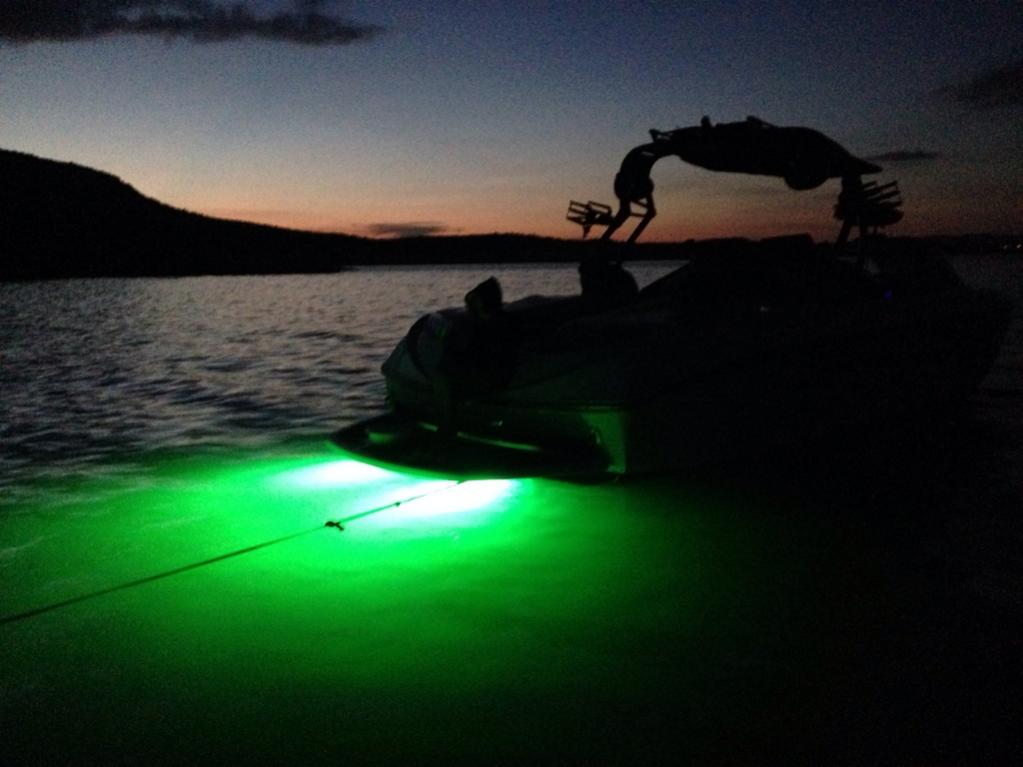

                            Here's a follow up on this discussion... Lifeform 9's-
                            Water here in this pic was terrible, nasty north wind had the south side of my lake looking nearly as bad as the caramel version of Mississippi. Filthy.
                            Very very happy with their performance and output. Whatever the beam angle is, I like it. Looks awesome underway, Iike something out of Star Wars. Satisfaction level is like with Rev10s.... 1 pair will thrill 99% of folks, zero desire for more.
