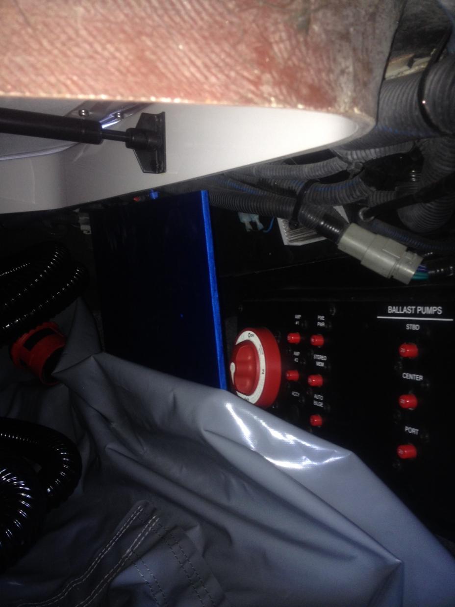

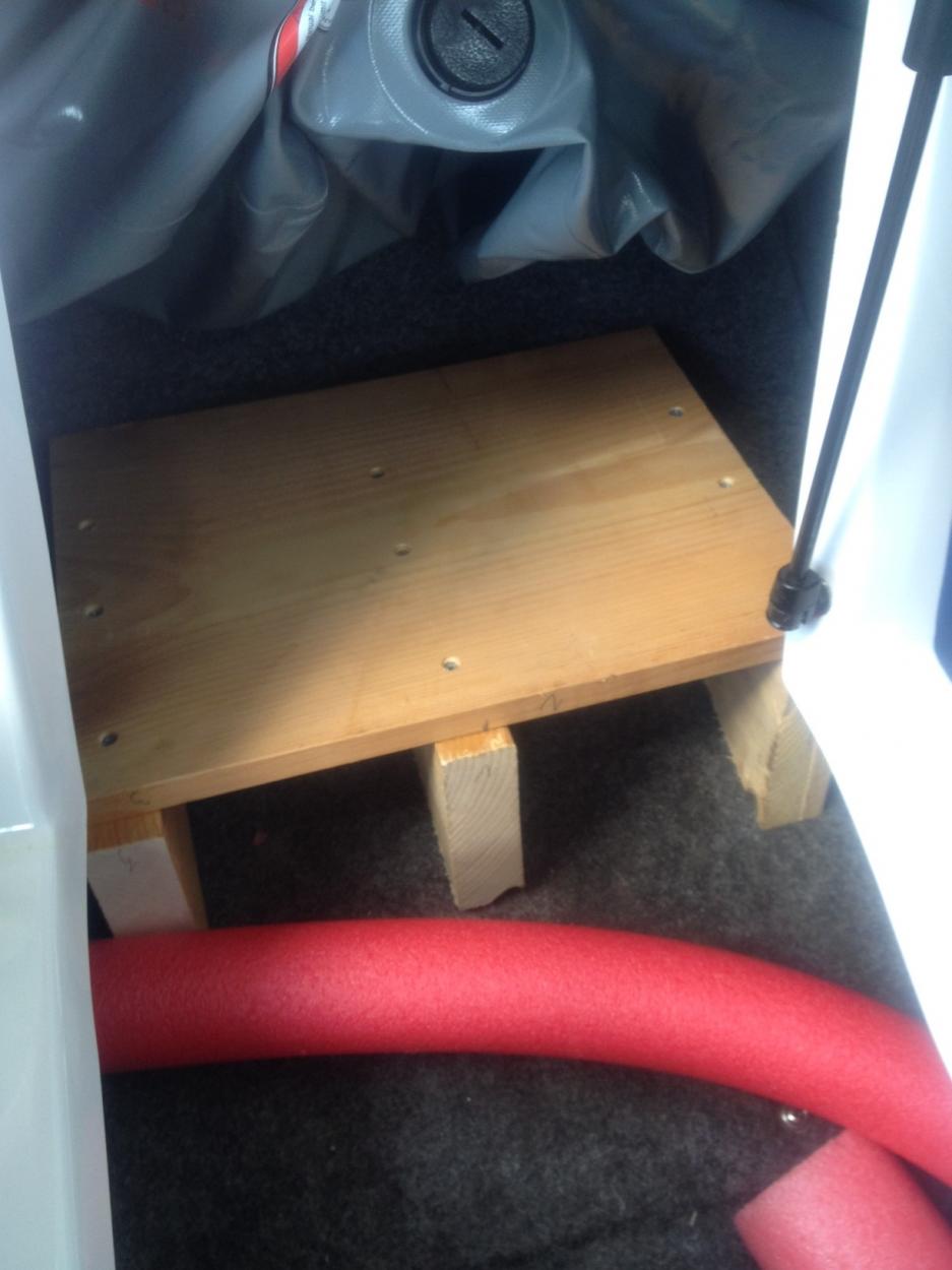

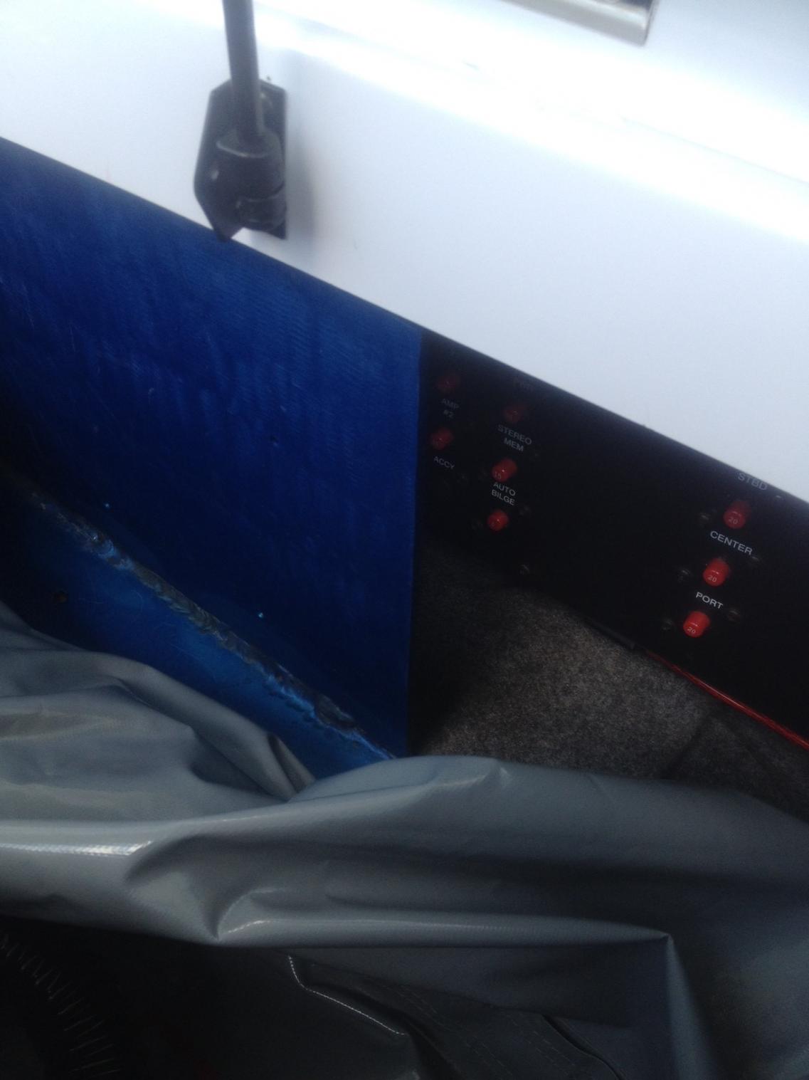

I still like mine but have made a L shaped aluminum plate to go under the bag on the port side. This keeps the bag from blubbering over against the battery switch and circuit breakers. I also made a small wooden wedge to go under the front of the bag to keep it level which makes it much easier to fill and empty while it is setting on the hard tanks. I will post some photos of the 2 pieces when I get back in town.2008 210 SANTE
Paxdad. Please give me a little more info on the plate that blocks the switch panel?Originally posted by Paxdad View PostHere are the photos of the plate I made to keep the bag from riding against the switch/ circuit panel as well as the wedge to keep the bag level. The wedge is a must have as once the bag is full the access through the port is very difficult. [ATTACH=CONFIG]28455[/ATTACH][ATTACH=CONFIG]28456[/ATTACH][ATTACH=CONFIG]28457[/ATTACH]
I just added the sumo 900's to my 220. The first thing I noticed was the slope. What did you do to keep the wedge from sliding?
The plate is made from (2) 1/8" aluminum plates and I welded them together like a really big "L" book end. They probably measure 16"x14" (16" being the bottom plate and 14" the upright sight against the circuit panel). I then had them anodized with some other items that we were sending out from my work.Originally posted by Silver Surf View PostPaxdad. Please give me a little more info on the plate that blocks the switch panel?
The weight of the bag keeps the wedge and plate from moving. If I want to use the bag on the starboard side I just move the wedge once the bag is drained. I recall the cuts on the 3 wedges were 20 degree angles using a speed/ framing square on a 2x6 board/ stud. I then used a piece of 1x12 shelving wood and glued and screwed it to the top of the 3 wedge pieces. Probably took all of twenty minutes to make the wedge. But it sure makes it easy to access the pop up port on the bag otherwise, the drain port is in a very difficult position to get the pump in the bag.2008 210 SANTE
