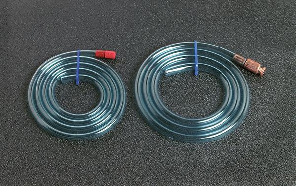

What is with the fitting on the hose? Does that go in the gas tank or the boat tank? I am assuming the gas tank and it is to keep the hose from suctioning to the bottom?

Google super siphon, Bass Pro sells them and maybe even your local auto parts or walmart.
Just a siphon hose, the brass end is the suction end which works like a ball check valve, they work really well. Gas Can goes on the sun deck or dock, ideally higher then the fuel destination point, pulse the hose up/dn 3-4 times, siphon starts, hands free after that.
If you are pouring gas in your boat on a regular basis go buy one for $8, trust me!!Last edited by Quinner; 04-10-2013, 02:08 PM.

I haven't used one of those siphon hoses, but I did take off the original spout and clamp on a nice 3 foot piece of flexible tubing. Makes it way easier when you have a heavy 8 gallon tank. That way you can poor from the dock with someone holding the tube. Works like a charm.1997 Ski Nautique
Ya the siphons are great as well.Originally posted by Quinner View PostNever used one of those new style can's, looks like a great solution.
Other then my small engine stuff, have not poured gas in years, these siphon hoses are the chit!!

Thanks Quinner I will have to check those out. I used to siphon the old fashioned way but got sick of the occasional drink of gas getting it started.Shawn

To start a siphon with out a check valve hose, get the siphon hose in the gas can, put the can above the tank the gas is going into, and get a second short hose. Stick both hoses into the can, and wrap a rag around both hoses where they go into the can. Blow air into the second hose to start the siphon.
The second short hose was what I was missing when I used to do it but that sounds like a good method too. I just had the one hose and a rag. I would blow into the gas tank and then cover but every now and then I would get a quick splash back and that was never fun.Shawn

That's a good one DC. Sometimes the obvious....just isn't so obvious.Originally posted by DanielC View PostTo start a siphon with out a check valve hose, get the siphon hose in the gas can, put the can above the tank the gas is going into, and get a second short hose. Stick both hoses into the can, and wrap a rag around both hoses where they go into the can. Blow air into the second hose to start the siphon.
