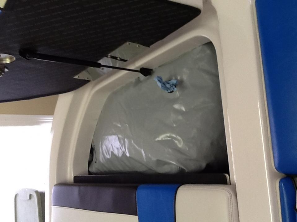

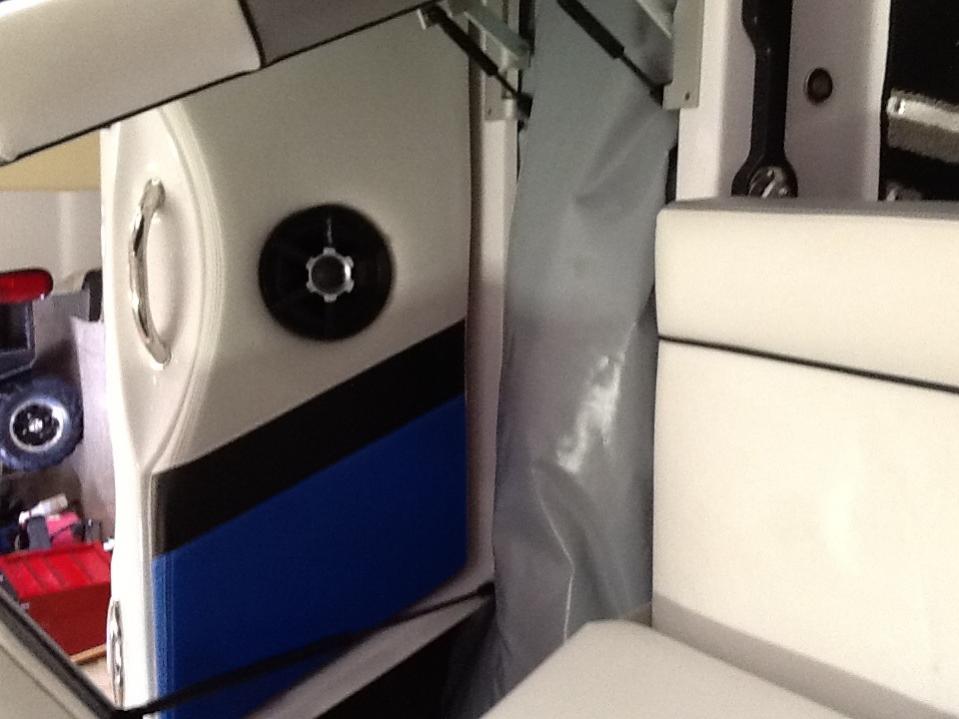

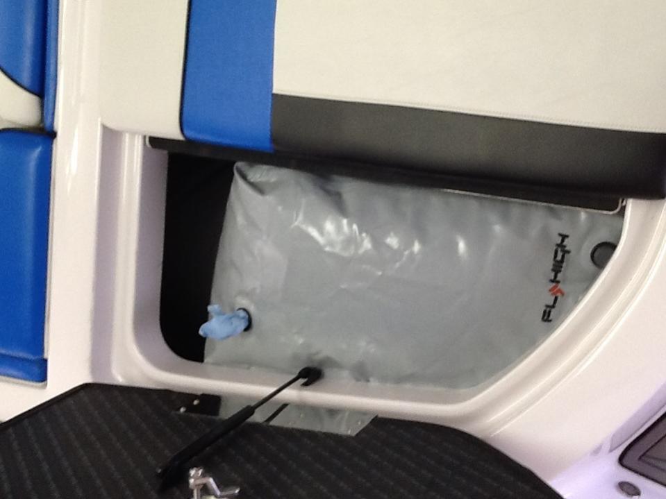

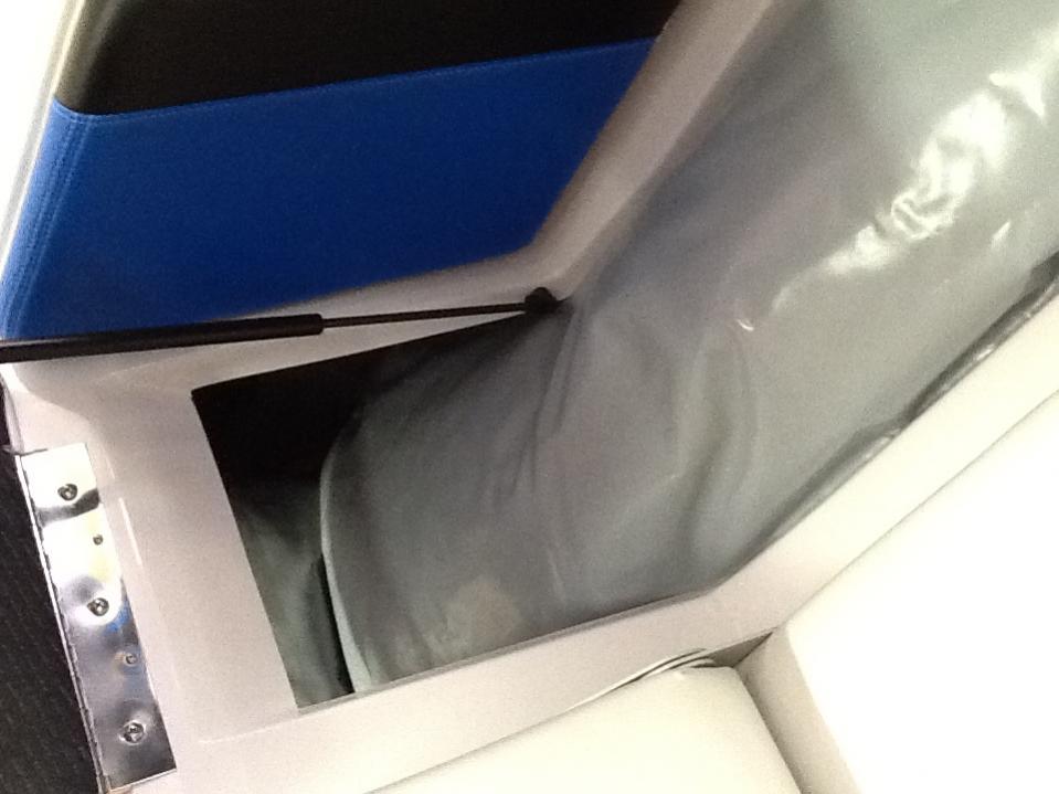

Hard tanks are out. Replaced starboard side with a 750 lb which makes nice wave for my kids who are 10 and under. Fixing to slap an Enzo on Port side and fill it all it will fit. Have to say it was simple to get the tanks out and sure does increase our storage space. Will update when the Enzo is installed with some pics.
