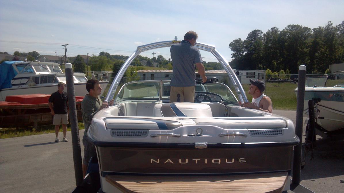

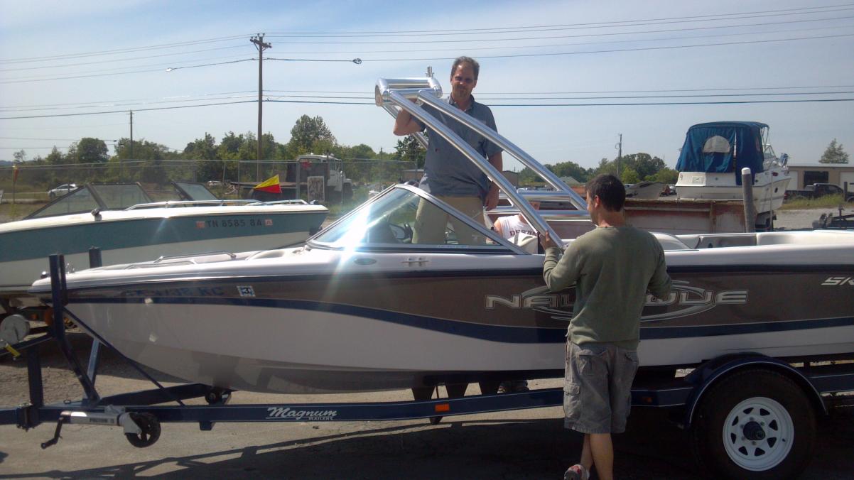

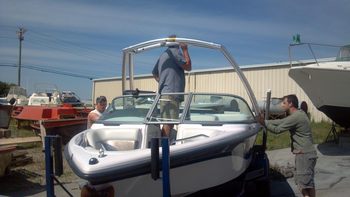

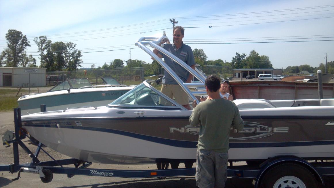

Tell me what you think of this tower on my 206
  • NCH2oSki
    • 1159
    • Maryville, TN
    • 2005 ski nautique 206 SE
    I know some of you will think its sacrilegious, since its not a FCT or New Diminsions. I usually think the same thing, but my buddy suggested we hold this up and see what it looks like. I'm honestly thinking about it, but was curious what the in crowd thought.
    We really use the tower to hold our bimini, and pull kids learning to ski. No one in the family wakeboards.......yet.
    So let me hear what you think.

    Kinda updates the look . I have to say it does look good . How much is it?

      Any reason why it's so far forward, I've always tried to center them where the tow point is as close to stock as possible? Does look pretty good even though I'm not a fan of that design, but that's more for function than for looks.

        I don't like it but it is WAY too far forward as noted above. It needs to be far enough back so that a straight boom can go out the side.
        Can you try again?

          will your boat handle the point load? I would imagine the new boats are reinforced to handle the concentrated loads. Do like the look but it is too far forward

                  Its the monster MTK, and retails for 1299.00. We were just messing around, its for another boat at his shop. I like the price, and the look is better than I thought it would be. It may be a little far forward, I was thinking about short line skiers and keeping the rope off the tower legs, and it allowed for other options on bimini's. I'm not a fan of over the tower bimini's.
                  I was at New Diminsions a couple weeks ago and talked to them about a tower, and surprisingly they did not have a pattern for a 206. We tried a 2004 196 and a 2005 216 but neither fit like it should.

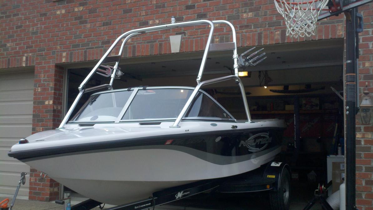

                              here is my nd on a 2005 196 skiClick image for larger version
ID:	363763Click image for larger version
