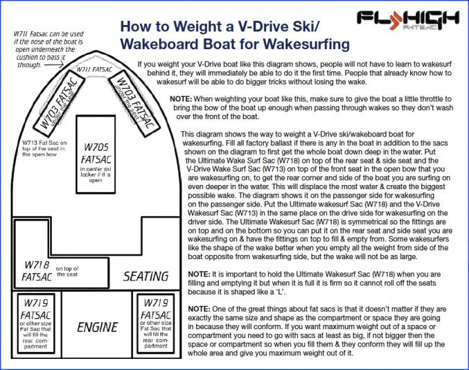

I’m trying to decide on which Fly High Fat Sac makes more sense. The goal is ballasting the boat for wake surfing.
Option 1
Pro X Series Jumbo V-Drive Wake Surf Sac: 50X24X24 – 1100 lbs
PROS: It’s 1100 lbs and if I decided to change hard ballast in the ski locker at a later date I could drop it in.
CONS: The seats are 20” wide so it’s too wide to sit on the port side seats and must sit on the floor.
Option 2
Pro Series Fat Sac: 50X20X20 – 750 lbs
PROS: It could be placed on either the port side seats, rear seats, or floorboard.
CONS: It is 450 lbs lighter than Option 1. Option 1 could/would be a better fit at a later date to replace the hard ballasts in the ski lockers.
Other info:
I have stock ballasts in the lockers plus 400 lb Fly High wedge sacks for each locker. I’m also getting a 1000 lb Pro X Series Open Bow Sac.
Looking for thoughts and advice on which Fat Sac is the better choice. The 1100 lb or 750 lb? Is everybody placing the 750 or 1100 Fat Sacs on the floor?
Thanks in advance for the help.
