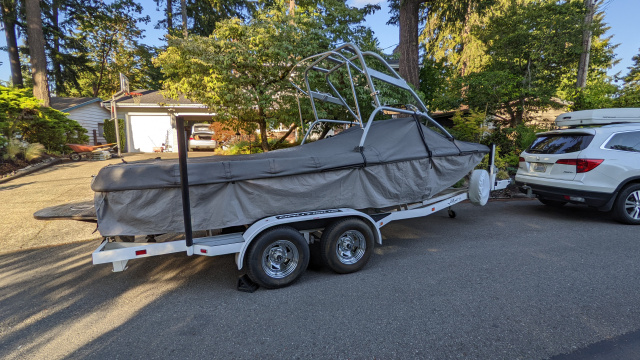

    Yup. I made my own from an old cotton/canvas boat cover that someone had given me. The cover had an existing cord drawstring around the edge and sewn on nylon trailer tie down straps simplifying the project.
    To make the skirts, I cut the cover in half at the center line. I then flipped the sides to make the outter edge with the drawstring the top of the side skirt. I tied each drawstring end to the bow/stern lifting rings to tension the cover end to end. Then I used the tie straps (that were now on the upper edge) to loop midship around grab rails and the tower base to support the middle section of the cover. Once hung, I used some marking chalk and drew a bottom line to follow the boat and cut away the excess and finished with hem line.
    Here are the skirts right after I finished them - the fabric is all wrinkled as the donor cover sat in a box for years. They look better now. You can see how I use the top cover to help hold them one and how they tie to the aft hand rails. If you look carefully, you can just see the tops of the tiedown straps at the gunnel - there are four with the most visible one wrapped around the tower. When I fabbed them, I did a little work in the back to wrap the skirts around the transom for improved cover and then use a poly trap with some tie straps to protect the stern. Didn't have sufficient fabric to make a stern cover.
    Super happy with the results for what turned out to $0 and an afternoon's work. They have absolutely worked great.
    Happy to try to answer any questions you have.

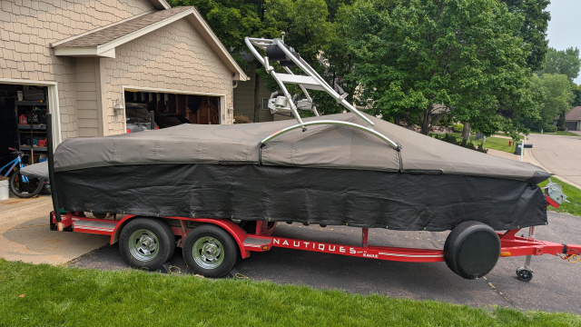

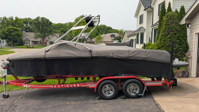

                        I finally got around to this project and can say that I'm extremely happy with the result! I think they turned out very well.

                          Looks like you ran the stock fabric width the entire length of the boat? That is, you didn't trim and re-hem the bottom...? What width is that 3 ft length? Did you end up using the snaps to connect the top side?
                          Bellevue WA
                          • MN Ryan
                            • Aug 2020
                            • 1398
                            • Maple Grove, MN
                            • 2007 SV-211 TE
                            Yes, I ran the width the entire left of the boat--I think it's 2' 8". And yes, I installed snaps asking the top hem, and it worked perfectly.
