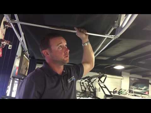

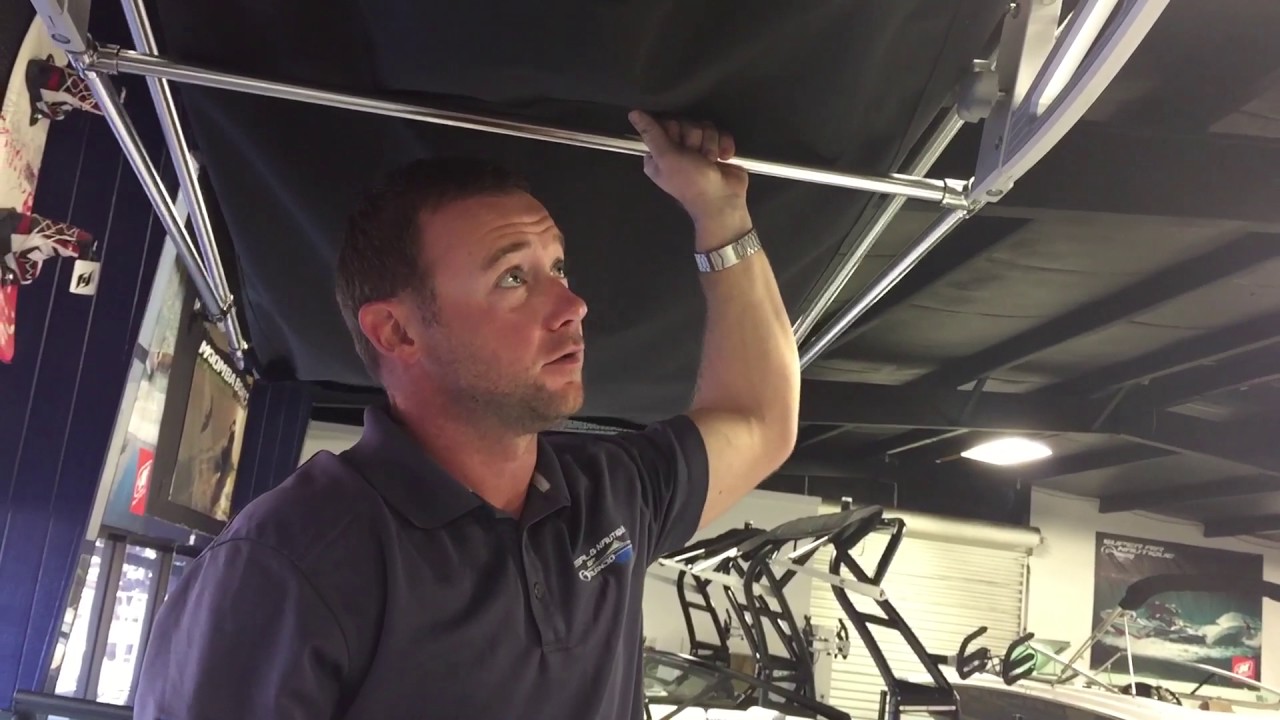

I bought a 2014 G23 that came with the flight control tower and bimini. When folding the tower down, Im having a problem with the bimini frame (where the threaded knob goes through) scratching the windshield unless I have a person in the bow strictly for holding the bimini off the glass. The only info I can find is this video showing the tower folding process on this tower and this guy lets go of the bimini and it holds itself up. Is there a part I'm missing on my bimini or do I have to find a way to add gas shocks to keep my bimini off the windshield? Here is the video im referencing at the 1:30 mark
