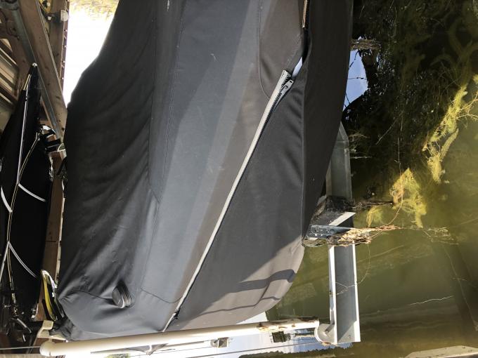

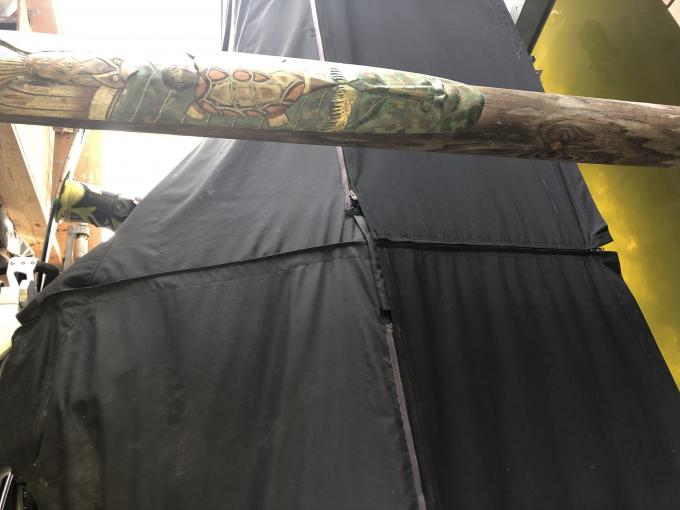

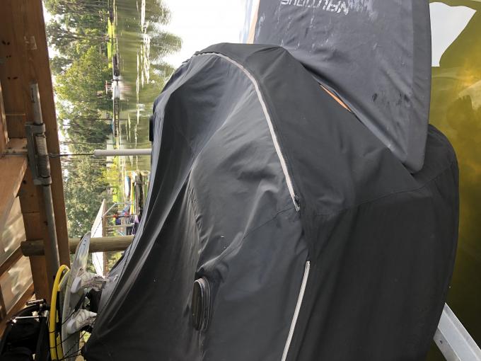

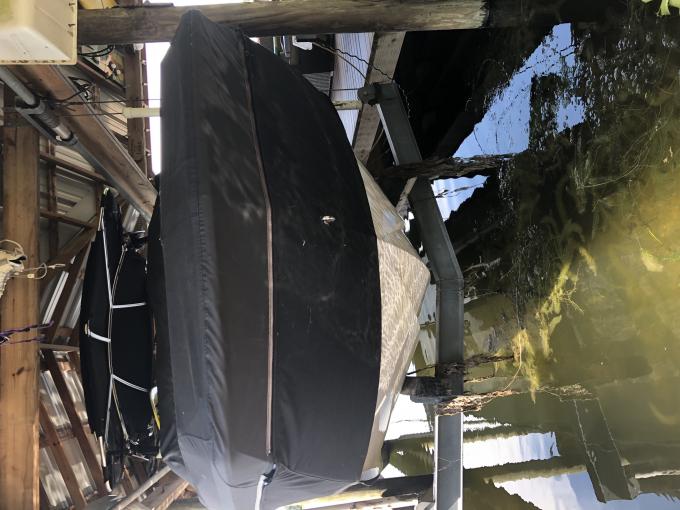

                I had a canvas shop put heavy duty zippers around the bottom of the factory cover and then made 2 big U shaped skirts. One goes around the front, the other around the back. They mate up where the factory cover splits so I just unzip those 2 extra zippers in the middle and roll it up like I would the factory cover.
