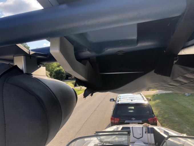

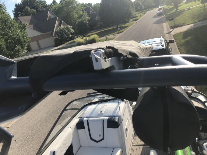

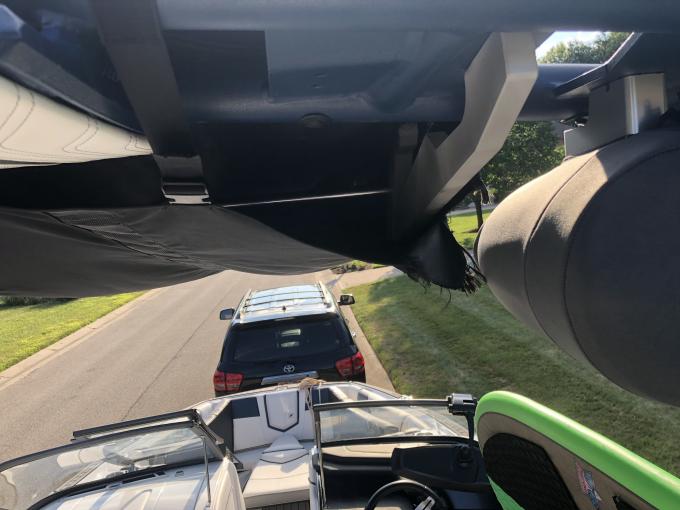

              The reason for the question is that my cover for the Bimini shredded itself where the edges were flapping.

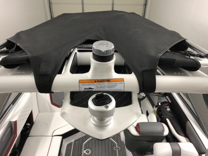

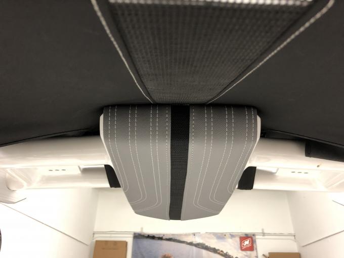

                    There is a certain to way to put the cover on that eliminates flapping, the way you tuck things around. It isn't obvious, but it works great and keeps everything solid at highway speeds. If you just slide it on and velcro it will shred up pretty fast. I'll try to get a pic that shows it.

                          Here are a couple of photos of the Bimini cover on our G. The trick is how you tuck up the bottom and run the straps to take up all the slack.

                              It should. I have towed across several states on interstates with no flapping or issues. One time it just got slid on and strapped - like you likely had it - and 20 minutes down the road it started to fray.
