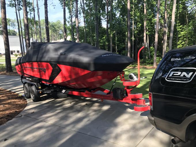

I always tow with the cover on . I bought a triangle shaped towable and place it upside down in the bow no poles in the back . I had trouble with the factory ratchet strap staying on at 70 and a head wind . So I had my wife [ who works at a cover shop ] sew on straps three on the side and two on the back. The key to damage free towing with the cover on is to make it as tight as possible any movement may cause scuffs to the gel.
Maybe you have the poles in place because you tow with the tower down. I tow with tower up, cover on, no pole, and the cover is not moving nor anything happen on a G21. Or maybe the G23 is different.Originally posted by NautiqueJeff View Post
