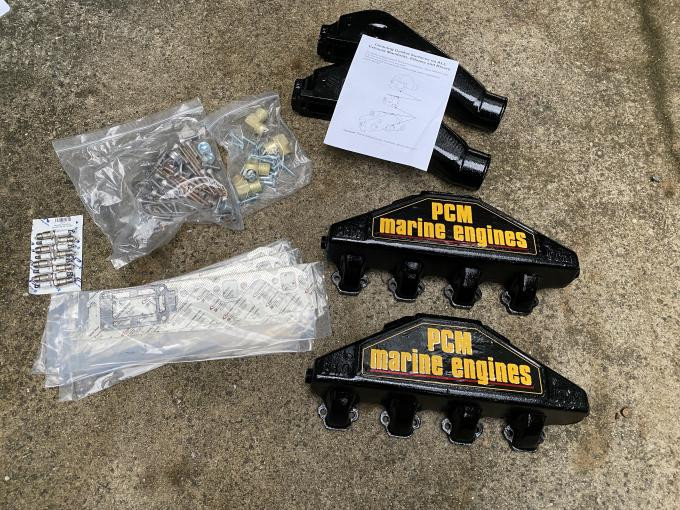

Originally posted by spenclo123
View Post
NautiqueParts just got them in yesterday.Please do not PM me directly asking for advice on how to repair your boat. While I would love to help everyone, I simply do not have time to respond to all of the inquiries. Please post your questions on the forum, so that all of our members have a chance to answer.
Correct. We'll see tomorrow. This is the first set I have ever tried to remove.Please do not PM me directly asking for advice on how to repair your boat. While I would love to help everyone, I simply do not have time to respond to all of the inquiries. Please post your questions on the forum, so that all of our members have a chance to answer.

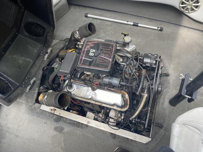

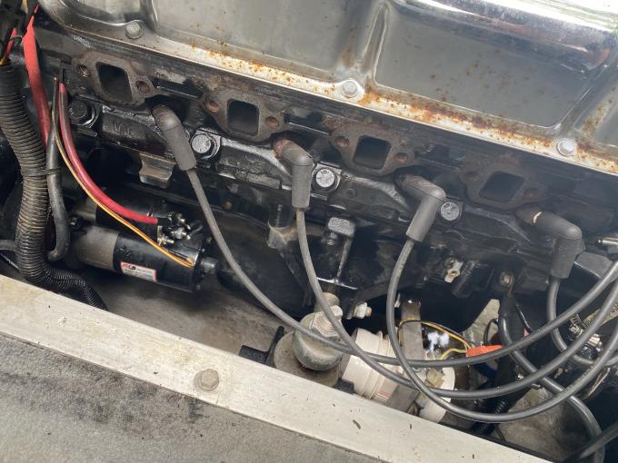

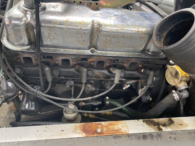

NO broken bolts! Woohoo!

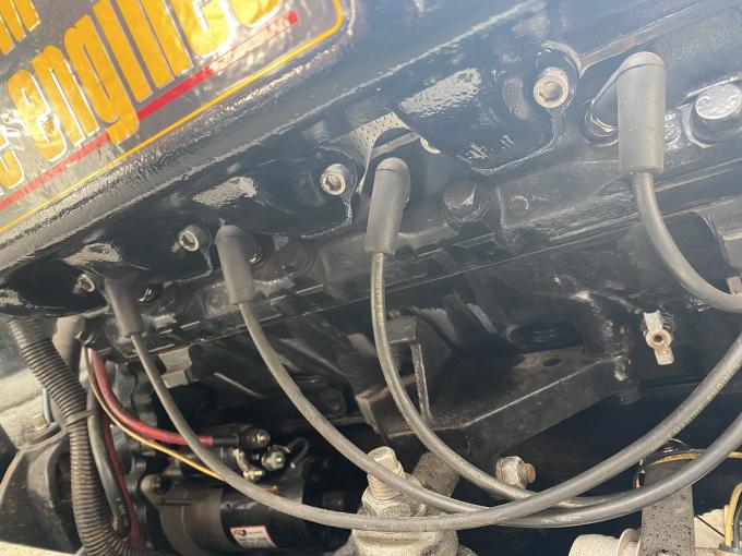

The manifolds and risers came off fairly easily this morning. I think the ATF/Acetone mix worked well.
Now to get the surfaces cleaned up and the new ones installed.

Well, the new risers were not the right ones for this boat. Not sure if it was my error or NP's.
Luckily, the original risers were not bad, so I just reused those, and luckily didn't break any bolts on those either!

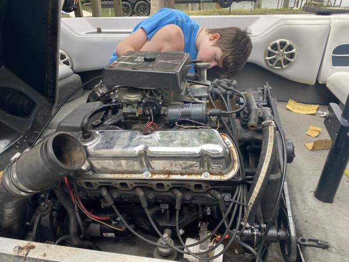

Everything is back together now, and the plugs have been changed too. We'll drop it in the water later this afternoon and go for a test ride.
I even got my son to help on this task! He cleaned the engine surfaces to prep them for the new manifolds and gaskets, then he helped lift and hold the new manifolds into place while I bolted them on, and then he gapped the new plugs.
Yeah, not sure if I screwed up or NP screwed up, but they were the wrong ones. I had to reuse the originals, but that's OK. They were still in good shape.Please do not PM me directly asking for advice on how to repair your boat. While I would love to help everyone, I simply do not have time to respond to all of the inquiries. Please post your questions on the forum, so that all of our members have a chance to answer.
Townsend probably does not run across that many non GT40's and just thought it used the 3" risers. Correct Craft probably wanted 3 1/2 risers across the board so that they didn't need different mufflers,hose sizes and other misc exhaust parts

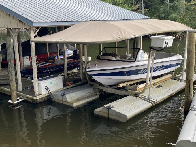

Got it in the water this evening, and it seems to run fine. It is safely on the lift, and ready for playing around tomorrow.
