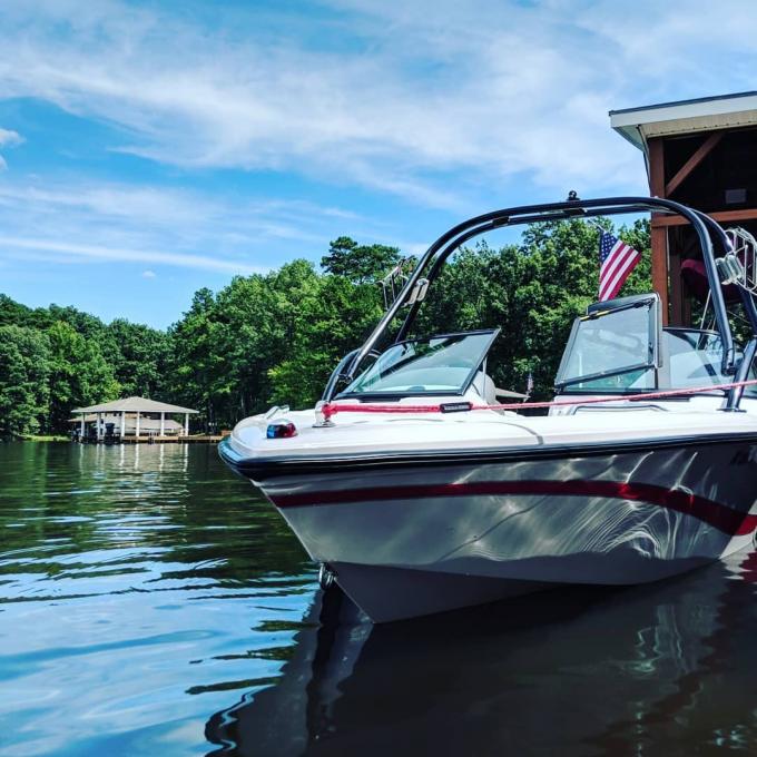

Just picked up this beauty. Very well maintained. 415 hours. 330 HP. Can't wait to spend more time with her.
