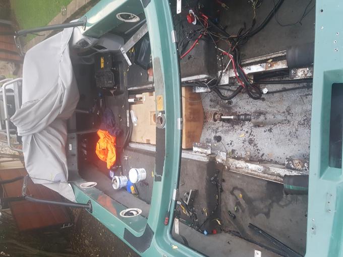

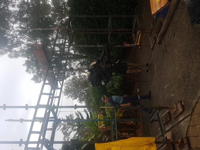

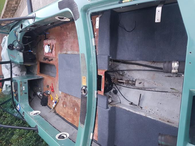

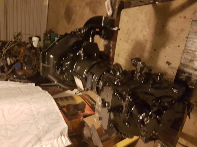

              so i have finally got the boat home and have started to pull it apart. Pulled the motor out yesterday came out alot easier then i thought it would, pulled it all out in one piece. Now the fun can begin . Sorry for the photos being sideways not sure how to fix them.

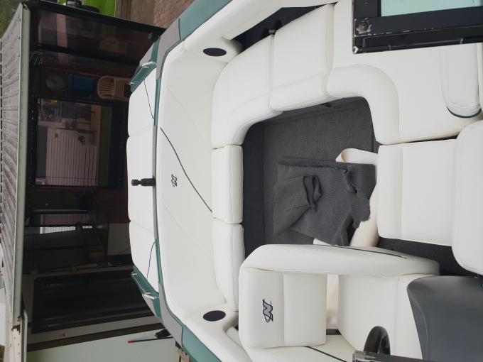

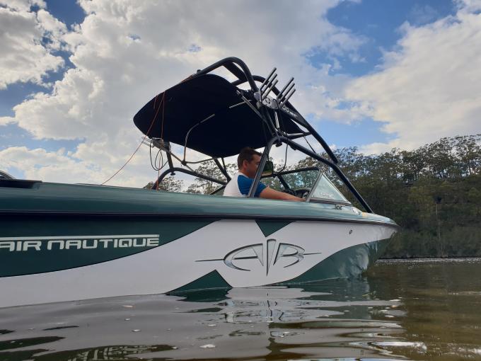

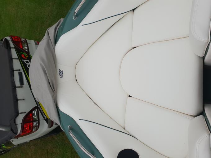

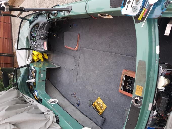

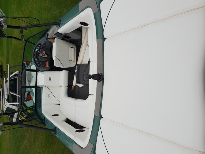

                    Its almost finished now just picked it up from the upholsters today. So happy with.
                    I have put new carpet though it.
                    have put the motor back in after cleaning it all up.

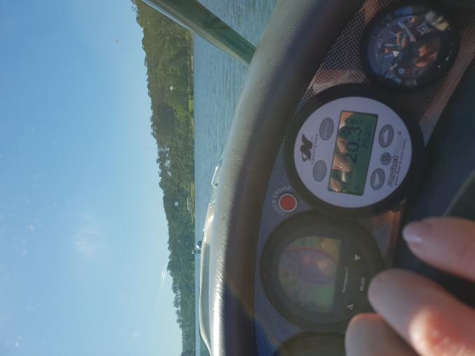

                    new Stargazer Perfect Pass
                    have put a new ballast system in it, (no photos yet sorry)
                    just have the give the hull some love , paint the tower and tint the window.
