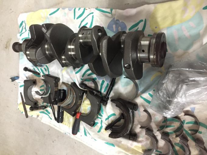

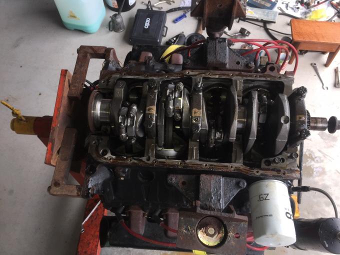

            It’s finally time to fix that pesky leaking oil pandoing big ends and mains + timing chain n gears whilst in here

                Seabrad Doing all of the work yourself. That's impressive!
                • Seabrad
                  • Jul 2016
                  • 27
                  • Cairns, Australia
                  • 1999 Pro Air Nautique

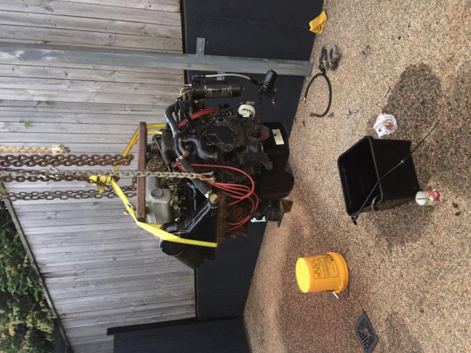

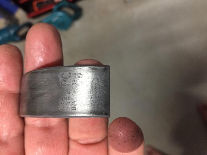

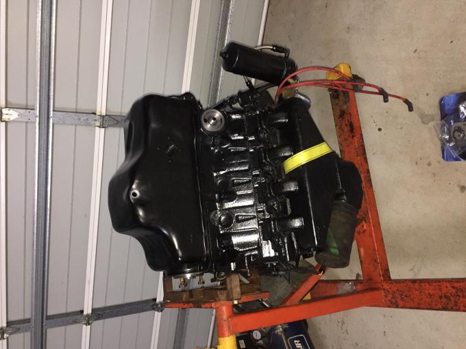

                  Yes Evening Shade, Started out as a what I thought was a RMS but turned out to be rear of oil pan gasket so engine out..whilst there with 790hrs on the engine changed out big end and main bearings, timing chain and gears, polished crank and installed speedy sleeve + front and rear main seals.
                  The biggest headache was the water pump gasket..turns out (in Australia) that the Ford circulation pump is off a 1965-1973 Mustang! Got one easy once I worked that out.
                  Engine back in the boat and running sweet as of last night so only alignment and shaft connection to go today and ready for the water for another 20years

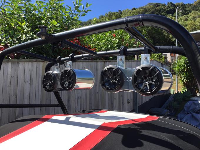

                      Finally got around to installing the tower speakers. Running an 1800W mono block amp for the sub and a 1000W 4Ch amp split between the tower and boat speakers.
                      Added a switch in the side of the passenger seat to isolate the tower speaker when not required.
                      Had to use a set of spotlight mounts for the speakers until I can track down an original set of mounting brackets. If anyone has some stashed in their shed and wants to shift them along lot me know.

                        Great work. You guys really know how to turn a wrench down there in AUS. Best looking Pro Air out there. Congrats. Have a good Summer!
