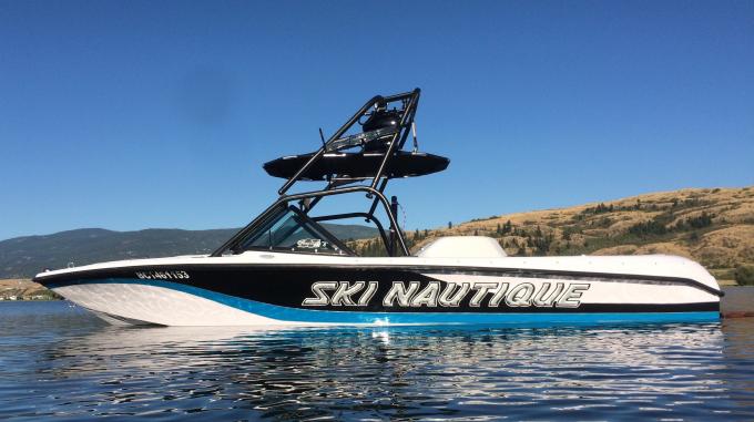

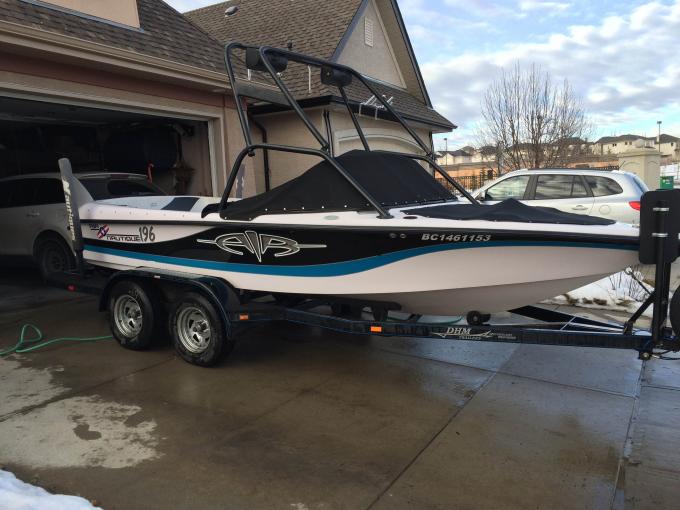

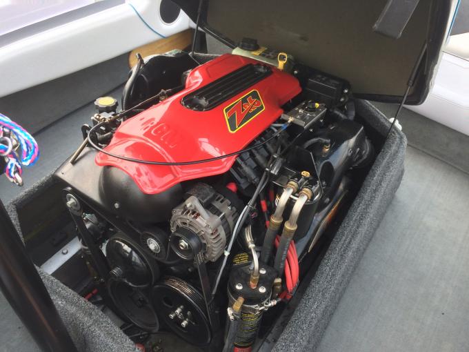

So she's finally done (well, you're never actually "done"). Stripped off all the old decals (boat is actually a 196 Air), polished the hull and put on new decals. Added Wet Sounds Pro 80s and sub and changed the engine. Replaced the original 2002 5 litre 305 HP PCM Chevie with a 2007 6 litre 375 HP ZR6. That was a bit more work than expected because we had to add 4" to the engine cover to accommodate the bigger engine. But everything worked out great in the end.

Is that throttle by wire? Do you use the same fuel pump with a different pressure regulator?
Big LS engine fan.
What do you use for engine mounts?
Same trans?
[QUOTE=DW SD;n552280] Awesome project! Congrats
Is that throttle by wire? no
Do you use the same fuel pump with a different pressure regulator? Used nothing from the old engine. Replacement engine came with all components.
Big LS engine fan.
What do you use for engine mounts? We used the same mounts, but had to fiddle with the base to get the right alignment.
Same trans? Yes

The graphic is a NautiqueParts special buy domed replacement decal for 2006-2007 196/206 nautiques.
Thank you! To confirm I put the desciption below. Is it sku #3303 or #90061 ?
ITEM NO. 3304 DECAL, “SKI NAUTIQUE”, HULL SIDE FOR 196/206, 2006-
$89.95 Quantity
ADD TO CART SKU: 3304 Description
8.25″X87.39″ Sold Ea
Was used on 196/206 boats in 2006-2007, and on retro style 2008-2009 boats. Also makes a great all around replacement decal for many year model boats.
NOTE: SEE DECAL #90061 FOR SPECIAL BUY DOMED (RAISED) DECAL VERSION OF THIS DECAL
Yes, it is a raised letter - a thick rounded vinyl. The letters are essentially grey and white with a black border and then a white border around the black border.
Couldn't tell you the difference from the standard one. Phone the guys at NautiqueParts, they will be able to give you more info.
