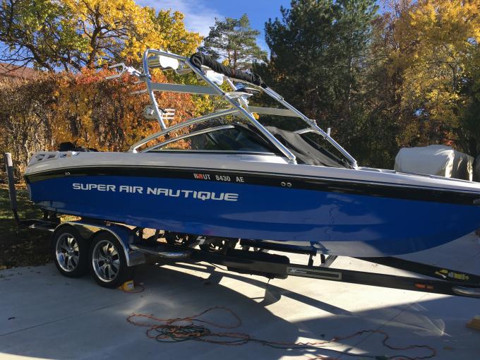

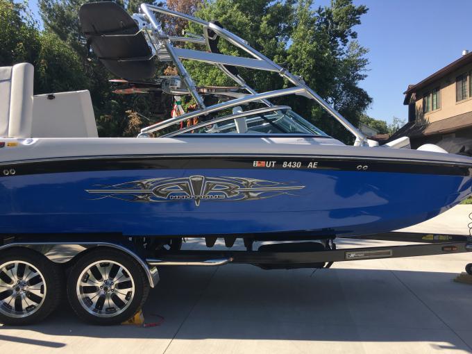

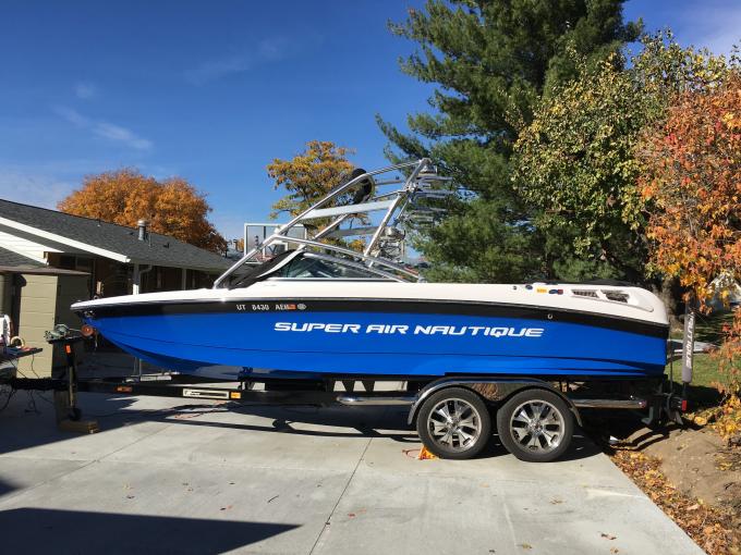

    I finally got rid of the tribal decal. I was never a huge fan. I think this is much cleaner.

    Nice work! That really does update the look of the boat and I'm with ya...
    Totally worth all the effort and cost.

      100% better looking . Much more of a classy look!

            I did it on a warm day with no heat gun. Plus I had my kids help. Once we got the main sticker off we used goo gone to clean off any remaining residue. That took a couple hours. Then I used a wool buffing pad with light duty rubbing compound followed by a polishing wax. That took 4 hours. Like your boat, mine has always been inside so the coloring distortion was very minimal. I used acetone right before I installed the decal to make sure it would stick well. I'm happy the way it turned out.
