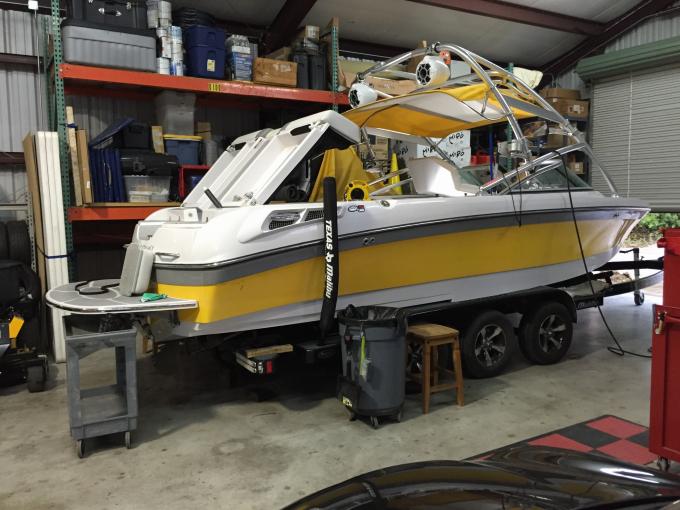

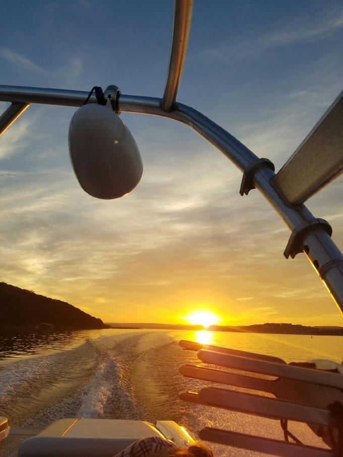

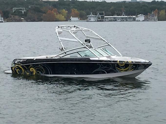

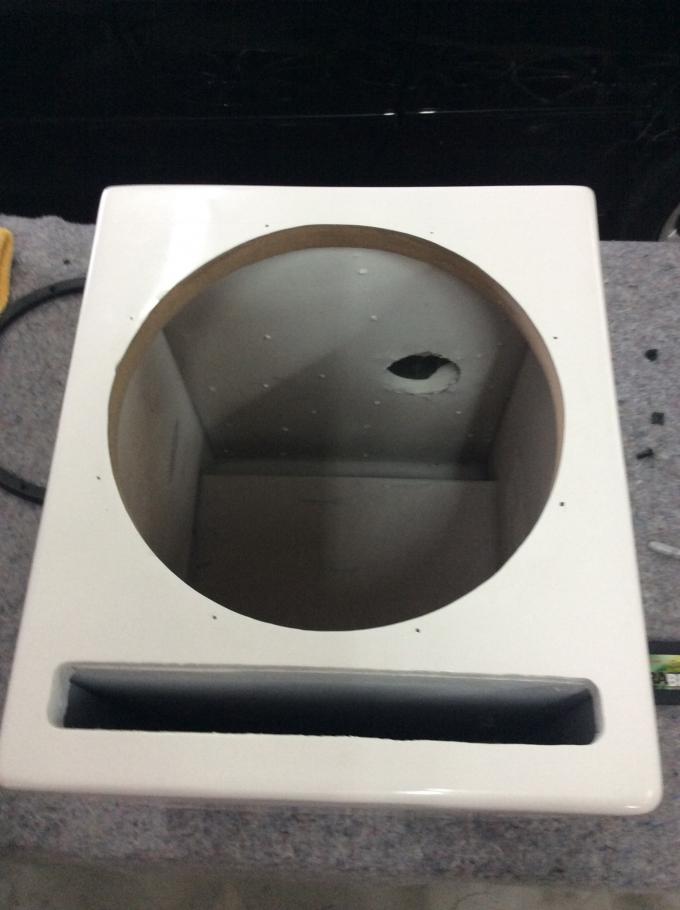

picked this boat up last summer in july, pulled out of the water in august and went to town on it. spent wayyy too much time and money trying to get yellow gel coat to match. took out the stock radio, added a din pocket there. bought the JL Audio mm100s and five pairs of mx650s. three pair in the stock in boat locations. one pair near drivers seat low and jump seat. another pair in the bilge access back wall. JL media master was place where factory remote formerly was. a pair of rev 8" on the tower. 12" ported sub box with custom silver cloud paint job. four amps total for three separate zones on the JL head unit. JL a1800 mono block sub amp driving 800watts rms on the sub zone. zone two is tower getting 200w at 4ohms to the rev8s. remaining two amps power the five in boat speakers. 1 four channel amp and one 6 channel. it will blow your ears off. mounting the head unit and drilling holes in the fiberglass were the most difficult aspects of the install. wiring took a while too. JL remote is in port side blige access conveniently tucked out of the way or elements, rain, sunlight and accidental song changes.
while it it was out of the water i installed three power LED underwater lights. 6000 kelvin temperature color, as bluer light travels farther in water than white green or red. two 500 lumen spot lights under the transom towards the outside. and one 2500 lumen flood light hooked up to a pitch adjustable lever so i can aim it up and project across the surface or point and down and light up the lake. threw a k&n spart arrestor on the motor with an amsoil waterproof prefilter and gave her some 10w-40 amsoil marine oil.

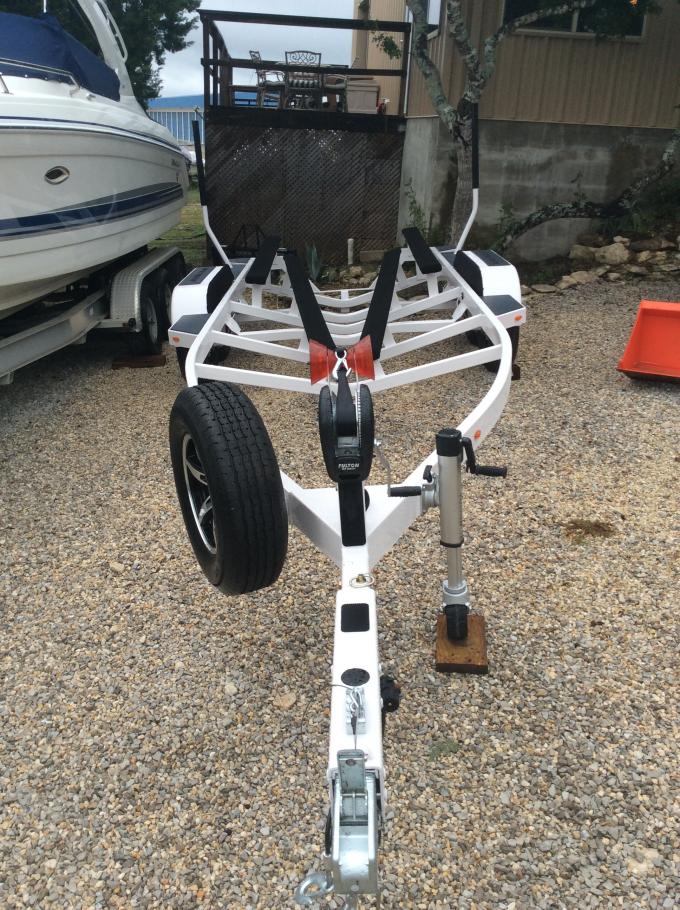

went to sail and ski, picked up fully loaded silver cloud boat mate trailer. tandem axle with led everything, collapseable tongue, upgrade wheels and run way lights. sail and ski really and boat mate really booked it, built it in less than 8 weeks.

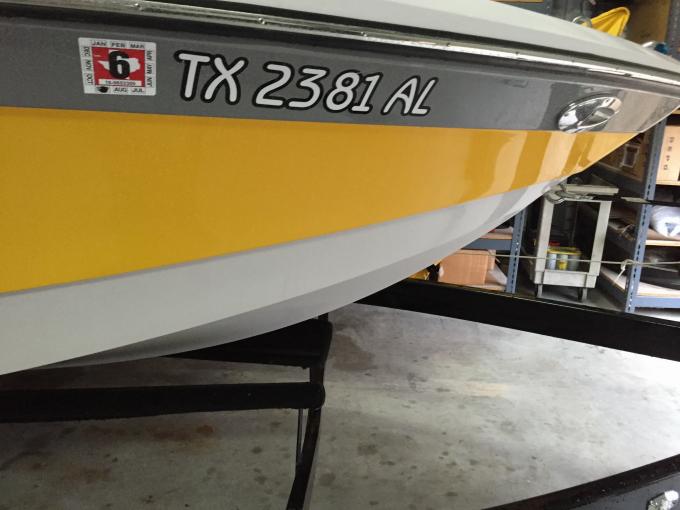

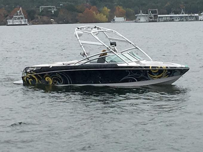

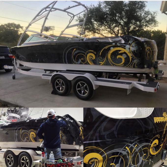

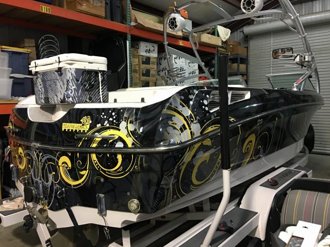

next we took it to wake graphics in austin Tx where mario and his crew did a custom spin on a paisley wrap for us. all the women like the exterior a lot better now and most dudes dig it too.
