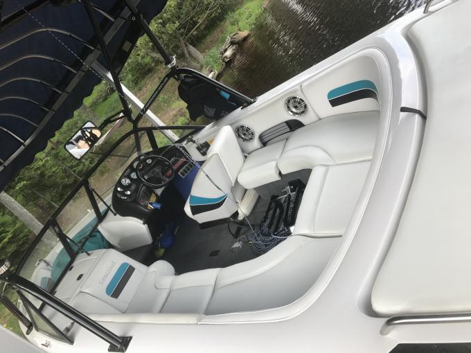

      In addition to re-fitting, I had the upholsterer make a new seat back and bottom for the driver seat, a new backrest for the arena, and a new playpen bottom.
      I removed the old pvc speaker tubes and mesh from the side panels and flush mounted 2 pairs of Polk db651's
      I pulled the carpet from the side seat base trays and cut in spaces for 2 stainless steel cup holders on each side, then re-glued the carpet.
      A corner of the center ski locker hatch was soft so I peeled back the carpet, cut out the soft spot with the dremel, and re-fiber glasses the corner- first filling with fiberglass resin filler where there was once foam core.
      So long as I was working with fiberglass resin I built a .8 CF sealed sub box for a 12" sub for under the helm out of 3/4" mDF and stainless hardware, coated the box with resin, and painted. Pics to come.
      I also had to patch an elongated fastener hole in the playpen cushion fiberglass back so it would pull tight to the hull when re attached.

        So long as I had the floor open in the boat I ran new 4awg accessory power wires from the battery to a fuse panel I built for ballast switches and amps for under the dash. I bundled these cables in 1" plastic conduit along with the ballast pump wires, hydrophase gps motor wire bundle, temp sensor wire, and hot shower power wire. Fishing this sucker was a PITA even though I had the floor up.
        I wired in 2 kicker amps which are mounted either side of the drivers feet - a zx350.4 for the 6.5's and a zx400.1 for a Polk db1240 sub. I had to make carpeted mounting panels for the walk thru side to hang the amp on, and I mounted the amp to a 1/2" sheet of HDPE that is secured to the hull where the accessory pouch would normally be.

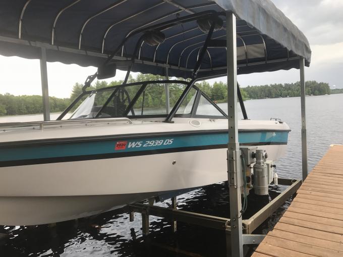

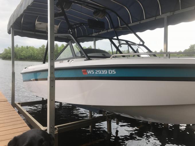

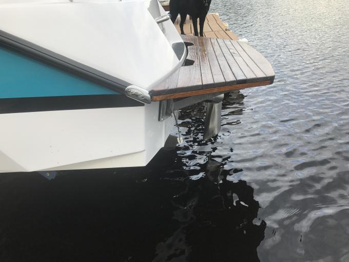

                          So I owe you all an update: boat work is done and I have put 10 hours on her in the few short weeks she's been in the water. The family is thrilled and our 4-month old Teagan loves being in the boat.
                          Thanks for for all the encouragement and wealth of knowledge from the members on this site!
                          Kyle
