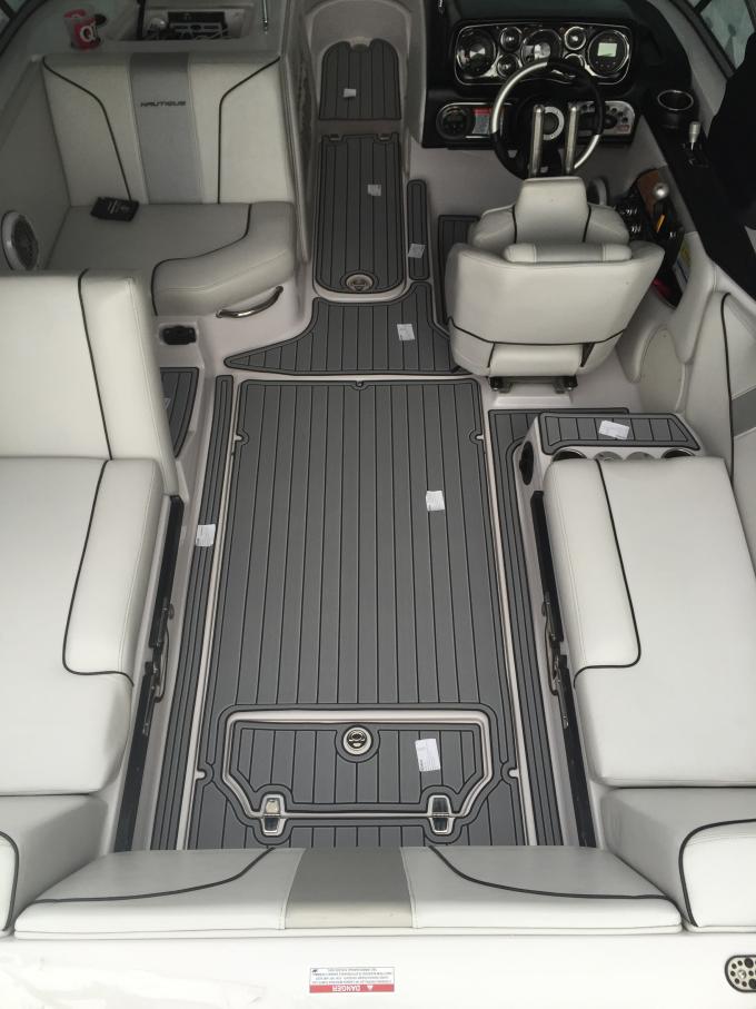

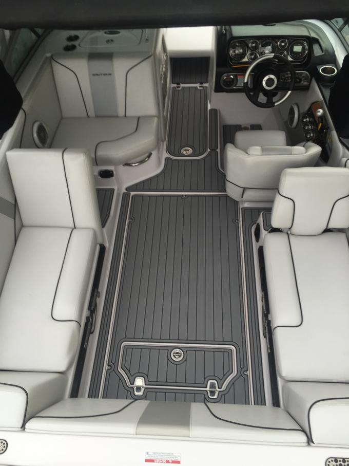

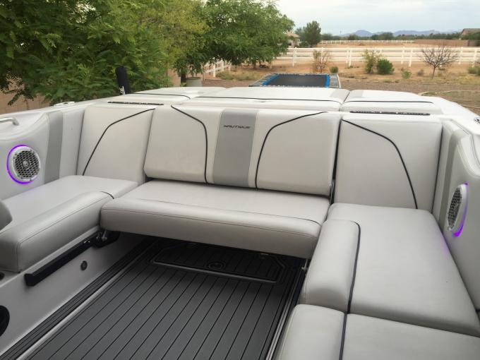

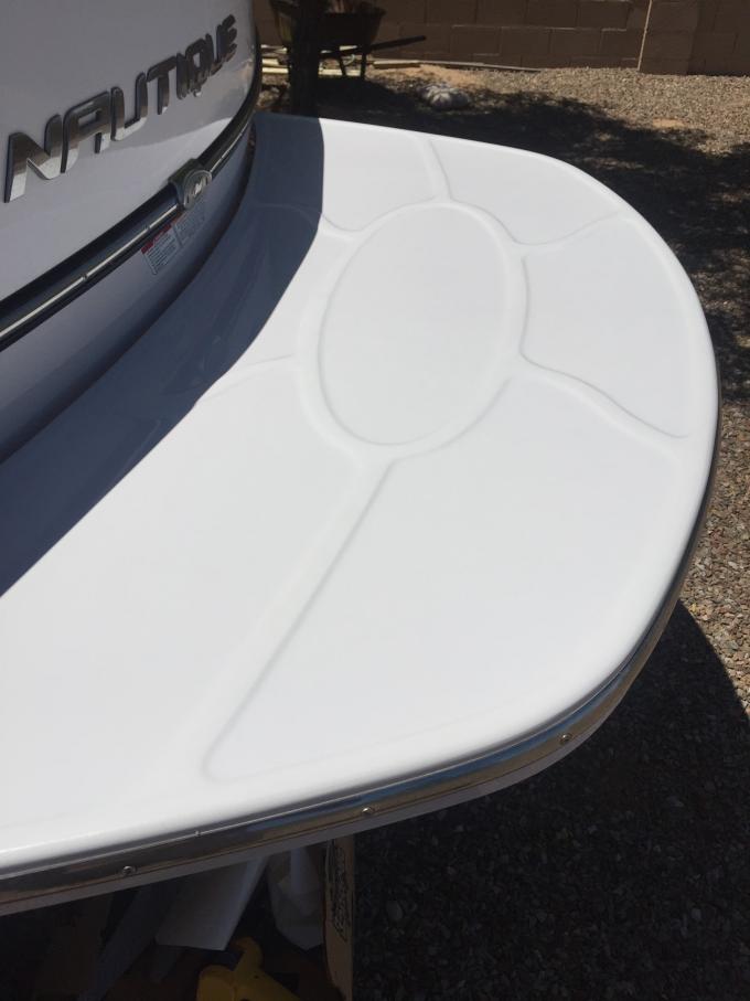

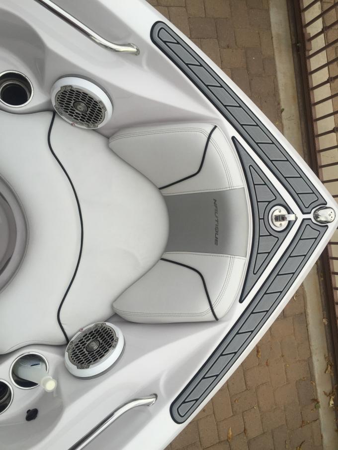

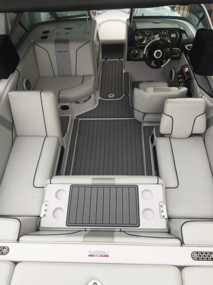

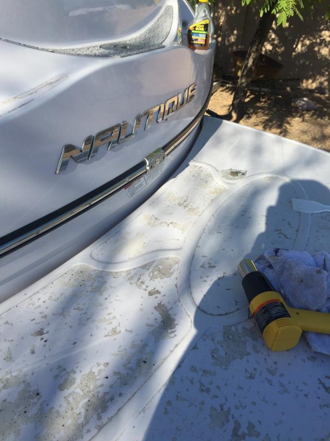

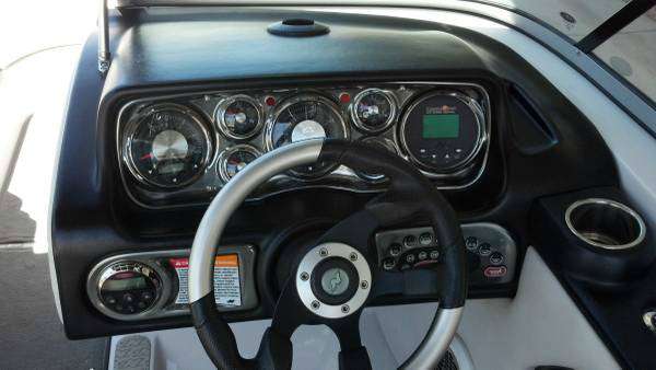

    Purchased my N2M SANTE 210 back in May. Just finished a complete Seadek makeover including platform, transom steps, interior and bow pieces. Removal of old SANO was a long tedious job that involved a heat gun and plastic scraper. Then removed the residue with Goof Off. Final cleaning with Acetone, then Seadek install. Platform and Transom steps (10 pieces total) took approx 8 hours. Interior (4 SANO pieces plus removal of snap-in carpet and snaps) plus three bow pieces took approx 5 hours. Overall very pleased with results. I think I am going to template the gunwales behind the tower most the way back and also replace the rubber/stainless pads directly behind rear seats as the final piece. Now to the pics:
    Couple of BEFORE shots:

    SANO removed from platform - lots of sticky residue to clean:

    Finished Platform/steps:

    Finished Interior:
ID:	501553 Click image for larger version
    Bow Pieces:

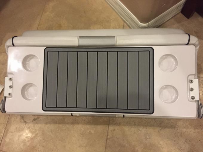

      Wow that looks awesome! I want to do the same thing in the same colors. Did that all come in one kit? I've also toyed with the idea of replacing the engine hatch pad with SeaDek (or maybe cutting it back and adding SeaDek down the middle) thought?

        I ordered the platform and transom pieces from NautiqueParts.com (remember the 10% PND Discount Code). The interior and bow pieces came from Seadek directly. I have the build sheet number if you need it. I love the idea of doing the engine hatch pad, but not sure how you would do it? Seadek can't be applied to vinyl (as far as I know) so it would need to be modified a bunch to make it work I think?
