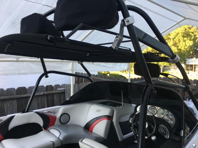

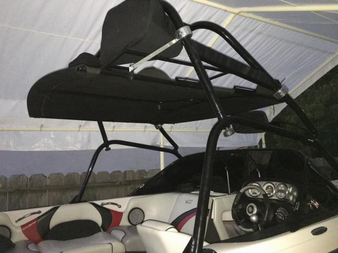

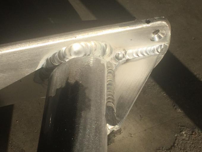

    Can you post some details of the tower gussets? I don't se them in any of your pics... What was the reasoning? I know the Rev410s add a BUNCH of weight and tend to make the tower rock side to side more on my tower. I have to keep an eye on the bolts and tighten them every season because they get loose even with nylock nuts.

      there on the rear mounts on the rear side.. the tower sways about half as much as it did before and the fresh powdercoat helped tighten everything up. I also printed out some plastic washers for the front shoulder joints to stop the rattle when I'm bombing across the lake
