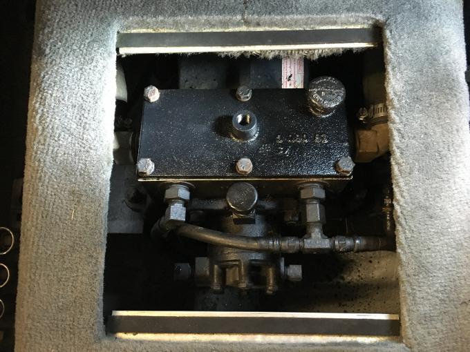

    thank you for posting all this... I'm about to buy a 2001 SAN ... it's good to know what under everything.
    so the boat I bought has a crack in the top cover... the guy didn't know it was there... I believe him. I haven't checked the dip stick... he also said he had just changed the oil in it.
        It has a crack in the top cover of the v-drive? If the oil looks fine, put some hours on it and keep a close eye on the oil. If it starts to turn milky at all then you've got further issues. If it stays clean then you can just buy a new top cover from Walter. I'm assuming you have a Walter, some came with a different model, but I believe most were equipped with the Walter. One good thing is you are close to Walter. They are located in New Jersey.
            Bought a New cover cleaned up Painted and installed.

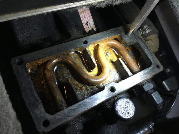

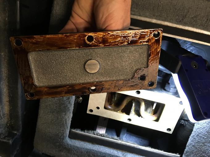

                      Decided I’d go ahead and attempt fixing the old heat exchanger. Mind you when I bought the boat this was unhooked at the engine so I was really not sure what all was wrong with it. All I know is that the solder joint on both stems is no good. Can’t be that hard to fix right? After all I had spent 5 days a week for the last 4 years on the end of a torch...lol
                      Well, moment of truth
                      And this baby leaks like a sieve from all directions!
                      This most definitely did not get properly winterized at some point in its life span. I will for sure be taking extra precautions when winterizing after installing a new one. Have to wait for NP to open back up after the new year to return the unwrapped heat exchanger for the wrapped one.
