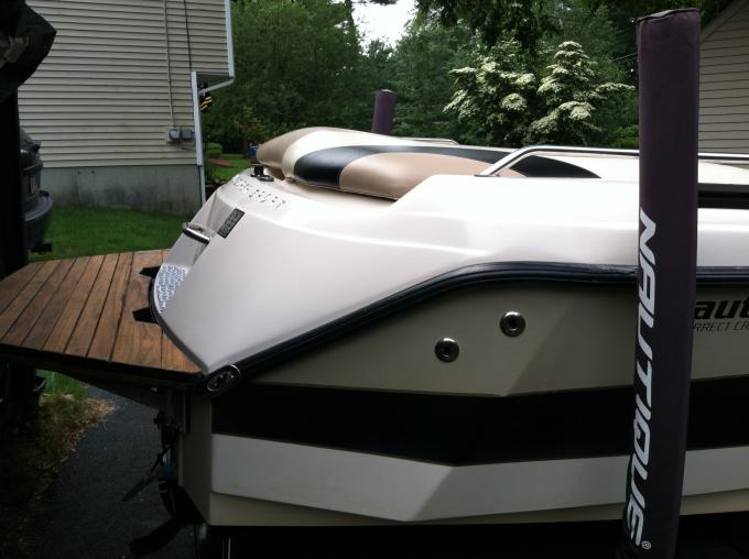

                          It might already be on your list but swapping out the plastic bilge/ballast outlets and rub rail end caps for stainless is an easy improvement that makes a big difference. Here is a pic of my boat after the upgrade. Bilge outlets are from Wakemakers and end caps are from Nautique Parts. I also swapped the factory cup holders for stainless. I found a great deal on E-bay for these that seem to be exactly the same as the Nautique ones at a fraction of the price. I can find that info for you if you want.
                          Shawn
                          2012 Blue Metal Flake SAN 230

                              Thanks for the positive feedback guys! @Shawn I kicked around the idea of doing that and then decided not too. I think I may end up doing it though after its all finished since the wetsanding and mainly buffing has stained the white plastic rings. Will make that decision once the rest of the buffing is finished!
