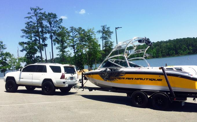

    My first boat purchase and I chose the 210 after debating between the x2 the 210 was the better choice hands down!!!.. Going to be a great summer! Look forward to being a part of a great forum!

    Great choice. The yellow on the blacked out trailer looks sharp
