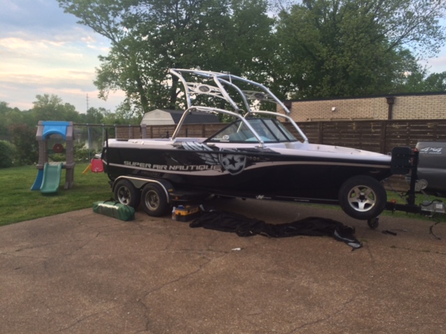

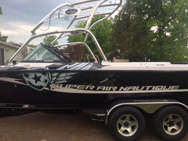

    Back in a SAN after a couple years in a 2005 x Star and glad to be back. Below are pictures of my New to Me 2003 Super Air Nautique TE after a lot of work. Wet Sand and Buff, New graphic, 2008 220 Tower, Ballast Upgrade fly high replacement of tanks, Wet Sounds Rev 3 Some and 4 wet sounds Amps, some interior work. Still have a couple small issues. 1. The Bags drain on their own as I'm riding so I have to keep the valves open (not a big Deal unless I get a loose hose then it would be). 2. Have a low voltage alarm in the dash only when I have a lot of accessories on. New Alternator, Batteries, and ground wire to dash but did not resolve the issue but also not a big deal.
