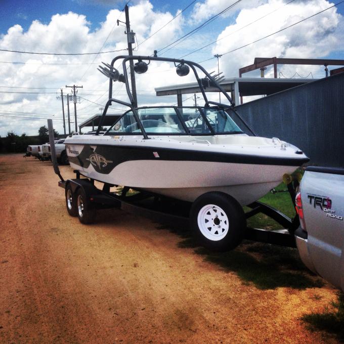

    Well I dove in this week. Family back in VA has a red white and blue '02 SANTE we bought from someone on this forum 7 years back. I guess I just missed her down in TX and had to finally get my own. I got a great deal on her because the tach is out (don't know the hours though). I plan on keeping her for awhile so that didn't bother me too much for resale. If anyone knows the previous owner though, I believe they were out of TN somewhere and in the military, might be cool to get some background on the boat.

    Nice, It looked good from the link you posted the other day.
    Believe it was on the Killeen Craigslist for a while which makes sense on location and Military involvement. It looked good in CL ad as well.
