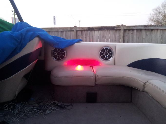

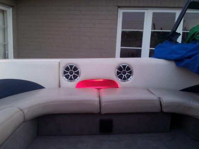

    So any tips on how you attached the front loaded speakers so flush like that? I am hoping to do the exact same thing and would appreciate any advice that you might have.
    The seats needed to redone so I just had them leave a little extra material so when I pulled the speakers tight they fit flush. used a pvc ring to act as a washer and screwed to that.
