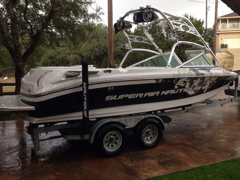

ID:	381127Wife and I just bought our first Nautique. 2007 SANTE 210 with Excalibur 330. Only been out a few times. Did some regular maintenance and tune up stuff since it's a used boat who knows when anything was done last.
